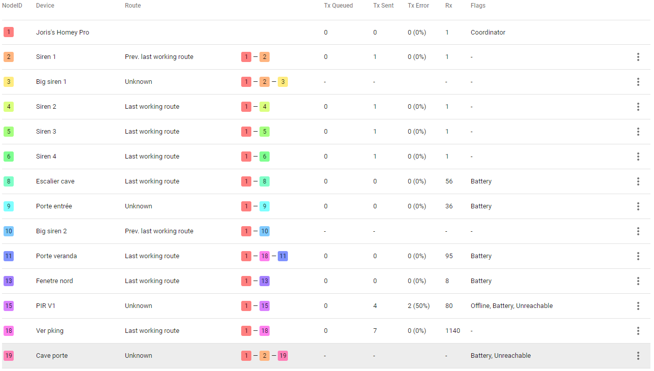

Well, it always sends reports about usage on every change that exceeds the threshold. But what appears strange to me is this looks like reports of the voltage metering and that it goes from 0 to 232 and back to 0. That’s shouldn’t happen when it’s just plugged in imo. Is there something plugged in in the power plug?
  1. to answer the question, Only a basic lamp that i only turned on once in the last 24H and is off the rest of the time
  2. i’m especially surprised by my PIR which shows “offfline” and unreachable but does tons of RX!
    and has a 50% error in TX, this PIR used to mesh over the plug that does too much RX, may be linked !
  3. Weirder even, node 3 and 19 are meshing over a battery powered small neocoolcam siren/alarm (node 2) sounds impossible
here is the full report :slight_smile:
http://www.mediafire.com/file/y9ilm9kqfnpq2or/New_Text_Document.txt/file
  1. Strange. Maybe i misinterpret the logging, not sure about that. When i find the time i will look at my Coolcam plugs logging’s.
  2. Unreachable is a farce. Don’t know when or why it is shown.If you switch the unreachable device off or on it does do that instantly. When you press test it says “reachable” and the status disappears…
  3. The nodes you refer to are “unknown” so their path is indeterminable. Very often that results in showing a path that is impossible (either through a device that isn’t there anymore or via a device that doesn’t even route).
    Unknown usually means that the device is REALLY unreachable (either because it isn’t powered or because it is out of reach).
