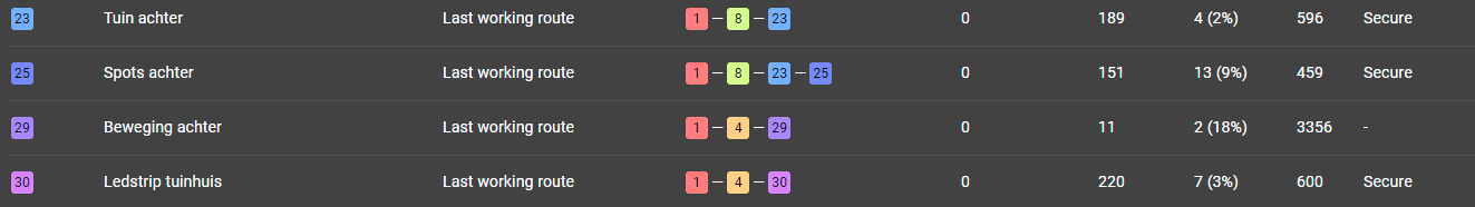

My z-wave network works almost flawless: I only have some trouble with the devices in my garden. Sometimes they switch on or off, and somtimes they don’t. It are the only z-wave devices I have these kind of trouble with. After looking at the developer page, it are also the only devices that have Tx errors. What could cause these errors/behaviour?
The rest of the network looks fine: not high amounts of Rx or Tx, only at the devices that you would expect, like motion sensors, have higher traffic.
If I test the nodes, I get the message the node is reachable:
But when I look at the log, I don’t always get a response:
And for one of the other ‘trouble-nodes’ I sometimes do:
Any ideas what could be the problem?
Probably it is not possible to give a general answer to this question.
The problem can be caused by many factors. Maybe the problems have something to do with the signal range and interference sources.
Exterior walls of houses are much thicker than interior walls. The used material (brick, gas concrete blocks, etc.) also plays a role. Aluminium window frames, Glas, and so on…
It could possibly help to shorten the distance between 2 actuators, one inside the house, one outside the house. Or use in general more actuators.
Thanks! Maybe it’s just that.
The strange part, but it could be because of local circumstances, that the route to Homey is: Homey - hallway - backyard. So the first step increases the distance to the backyard.
I would expect that the signal would ‘hop’ from one gardenlight to the other, until it reaches the one closest to Homey and the house (aprrox. 6 meters from Homey). But instead all the garden lights connect to the hallway on the other side of the house and then back to Homey. Maybe it’s better not to understand :slight_smile:
The route is not always logical.
