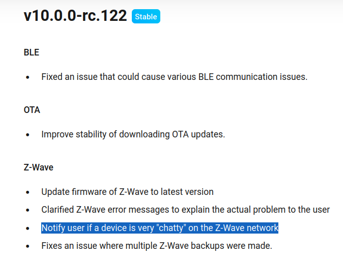

The stable rc.122 release mentions: user gets notified on ‘very chatty’ devices. Did you see any of those messages? While those devices can clutter up all traffic and should be edited so it sends less updates f.i. (just some thoughts).

I dont get any notification of noisy nodes. It just all comes as a big surprise.
