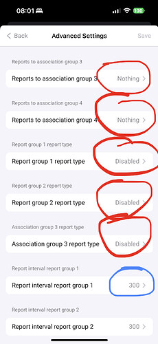

I’ve read several posts about these things ruining your mesh, because they’re very ‘chatty’.
Try to increase the intervals, avoid "every 1 second’ check-intervals and such;
Here’s an excellent explanation and howto:
