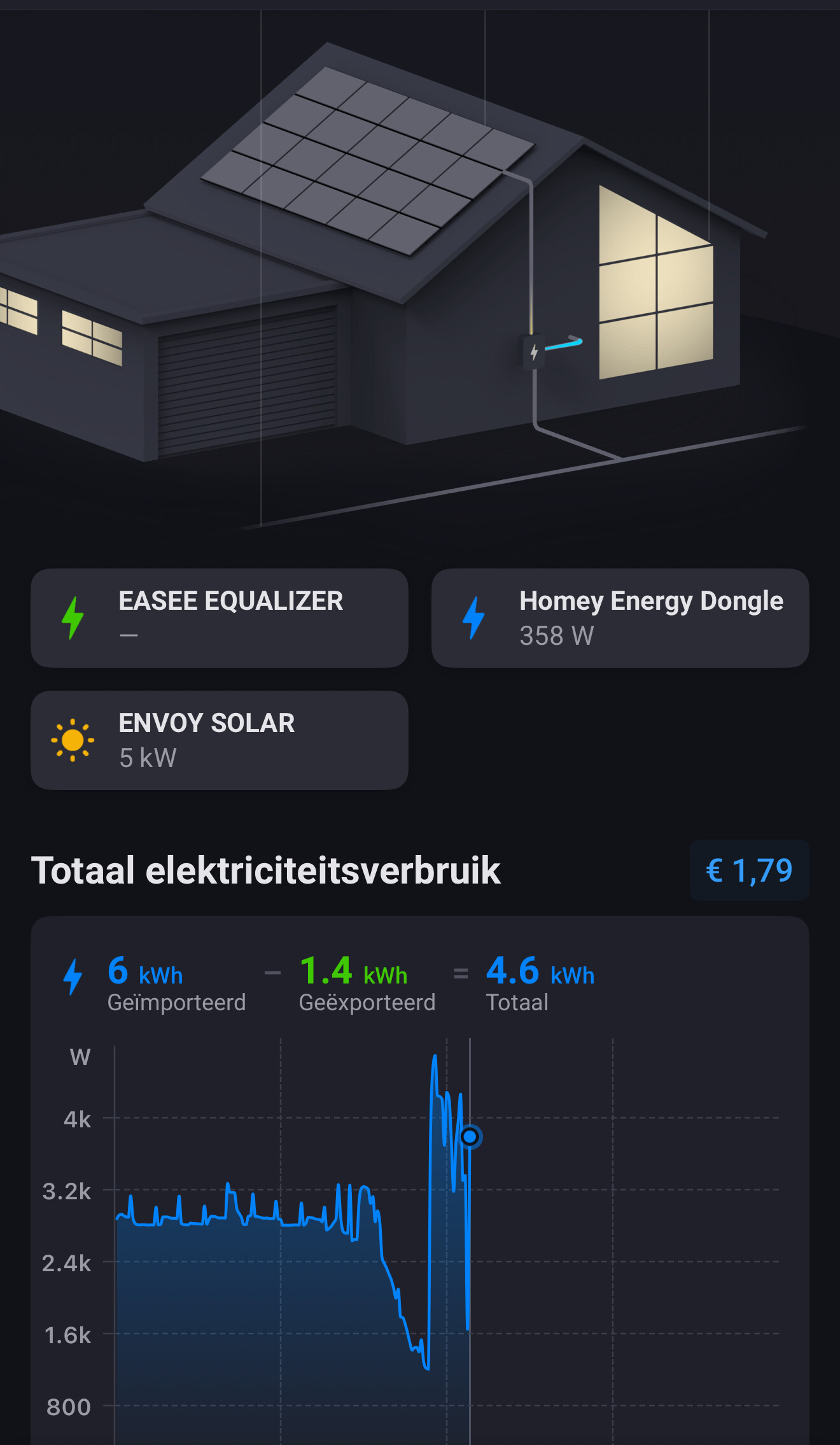

My car is charging but it doesn’t show up on the graphic. I remember that the first I saw a car in the garage while I’m charging but today it doesn’t. Something changed?
Thank you
I noticed that as well; That is what I actually meant with the last post. The energy dongle is reporting the telegram data correctly. It is a design choice to follow the dsmr specification. Personally I think a rounded value from the specification is odd, and would have expected that the current is calculated.
My car isn’t charging bur the animation shows its charging all the time. I think because the charging point is using 1 watt while idle. I think you only should see the animation when the point is active or maybe when more then x watt
