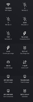

All values are refreshed every 1s with te info you smart meter transmits
and here are the screenshots for me ( Landis+Gyr E360 - 3 Fase - With Gas Meter, no Water meter connected)!
