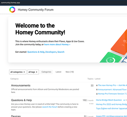

The start page is in English, this topic is in English…
The preferred language here is Dutch, and the site still shows English

I referred to the Homekit Controller page:
The link is on the page of the app.
But I didn´t want to critizise the forum or get into some kind of general discussion, just asked for help with the FP2 and the app…
