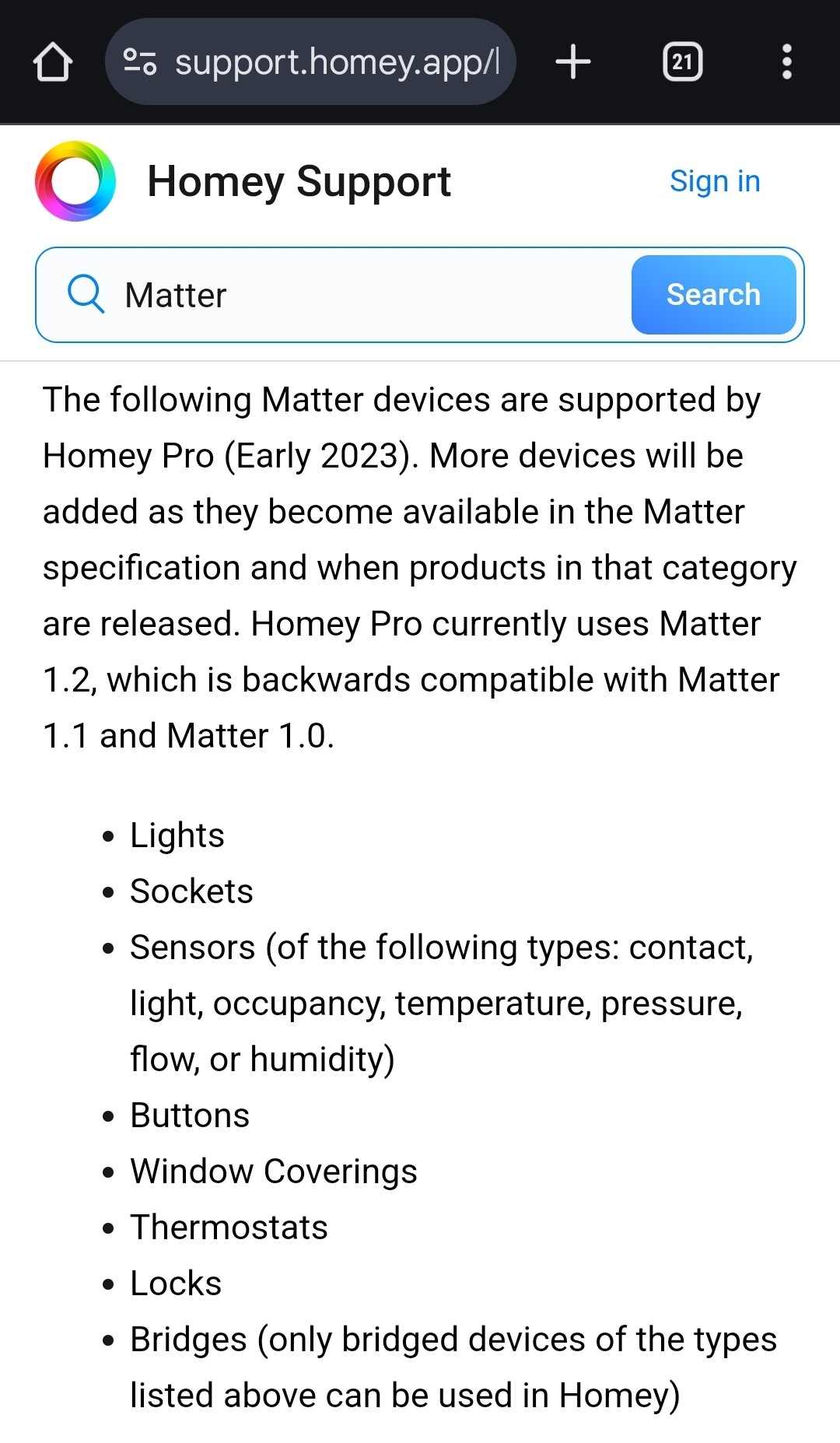

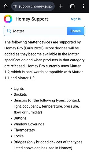

Does Homey regogize it with Matter?
Magic word: Aqara hub
Aqara does not have a Matter per-device.
Only when the Aqara zigbee devices are paired with the Aqara hub are they available as Matter devices.
Matter-over-bridge they call this construction.

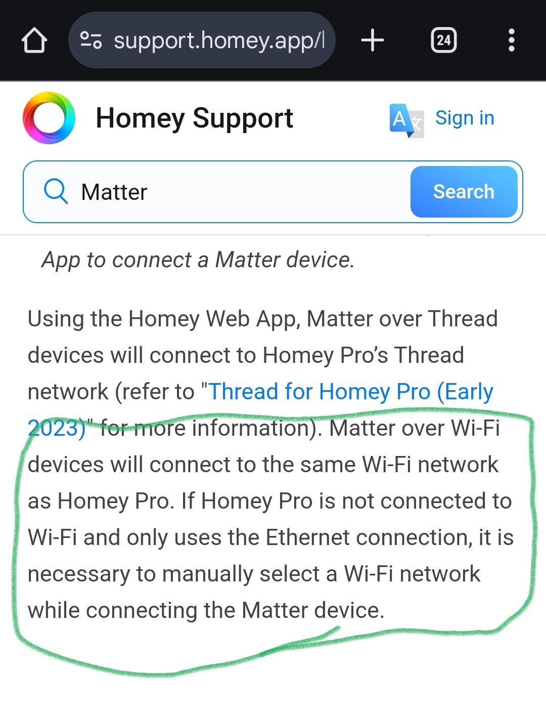

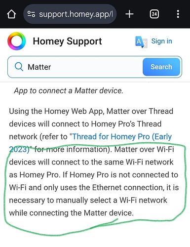

And what you circled above is interesting also as I have my Homey connected via the ethernet adapter so I may move it to wi-fi and try again. And then I may lose everything I have already set up. :grimacing:

When Homey is connected to ethernet, you should hand pick a wifi SSID for your sensor; Homey can’t possibly know which wifi SSID should be used because it’s totally unaware of your wifi SSID’s.

That’s simply because Matter devices don’t need an app, Michael. They’ll never end up as app device, not until someone writes a specific driver for a custom functionality for a Matter device.
Homey only supports the Occupancy part of the Matter specification, and maps it to “motion alarm” because there is no other official capability for it.
The Matter Occupancy Cluster has some other parts (like thresholds and delays), but Homey doesn’t implement them (and I don’t know if the Aqara even supports them).
