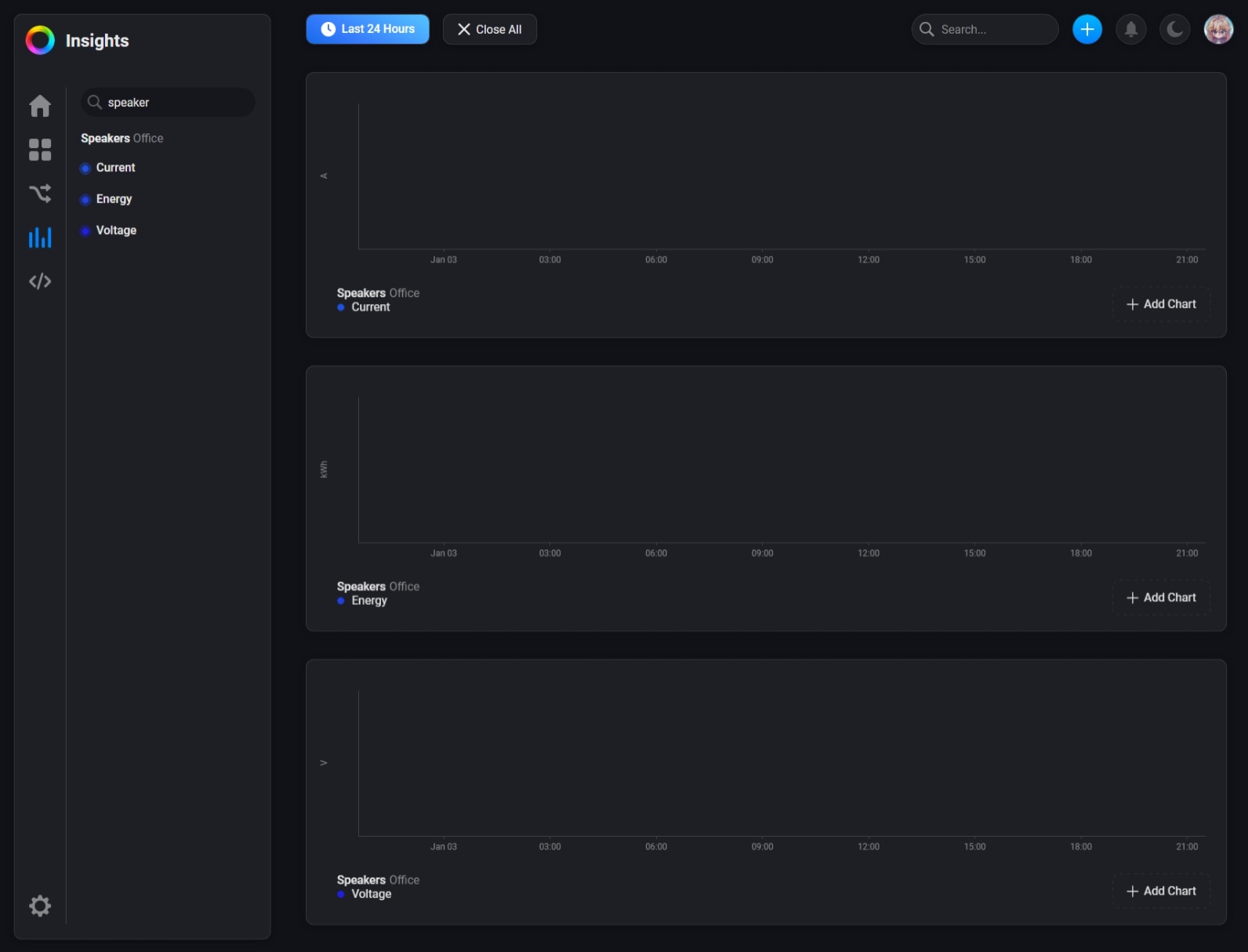

So I have now checked it and left it run for an hour - it now has the energy monitoring stuff but has zero data (as if it is turned off, but it isn’t)
I’ve left it even longer and now kwh has appeared to be getting reported but the other two are still empty. In HA I still get all the information fully.

You need the latest beta of Homey and you need the Meross beta (you have to email them).
Either way I still don’t get current/amps in Homey, only in HA, which is really disappointing.
@ConnorSParks I also have Meross plugs with beta firmware; the only data Homey can read right now is the total consumption registered by the plug. In the energy tab Homey splits the data correctly day by day but we are not able to see “instantaneous” current, voltage and power yet.
