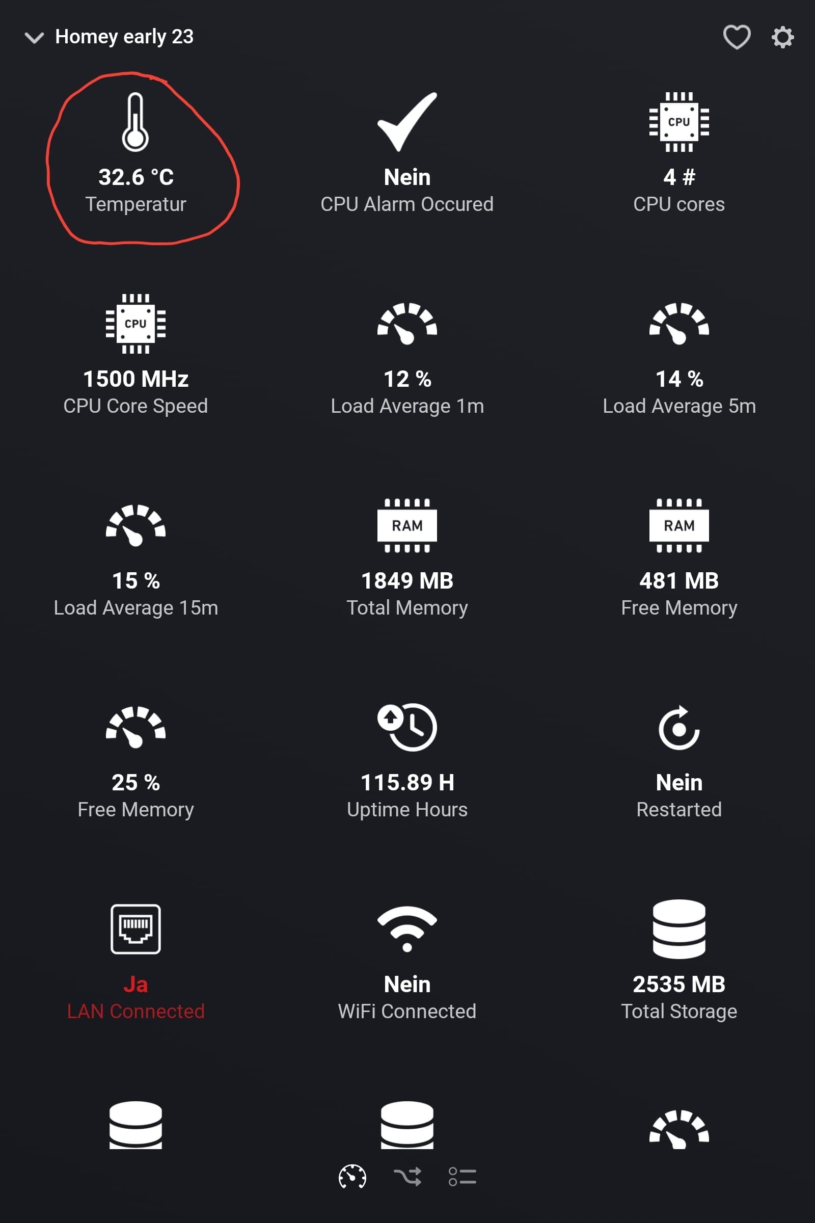

Have you ever checked what temperature Homey is ? With these hot days and an unfavourable location, the chips could go crazy if they overheat. :man_shrugging::question:
Homey doesn’t report its temperature but environment temperature is 29.5C.
Edit: Homey temp is 67.6C.
Yes, it does. Please use the app SysInternal !
Homey: 59,9c
28c in the room where Homey is located
OK, 60 degrees is not yet alarming. Homey, or the installed CM4 module, only clocks down at around 75 degrees.
The temperature should have nothing to do with your problem.
