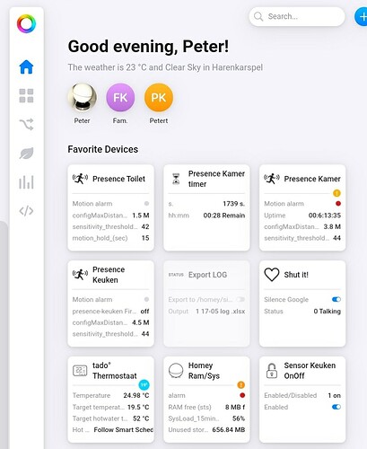

Maybe first click around a bit?
With apps you can kind of adjust your Homey to your needs.
Here’s a mobile Homey app device (from the DC app) which can control 3 curtains seperately and it shows the position of all 3:

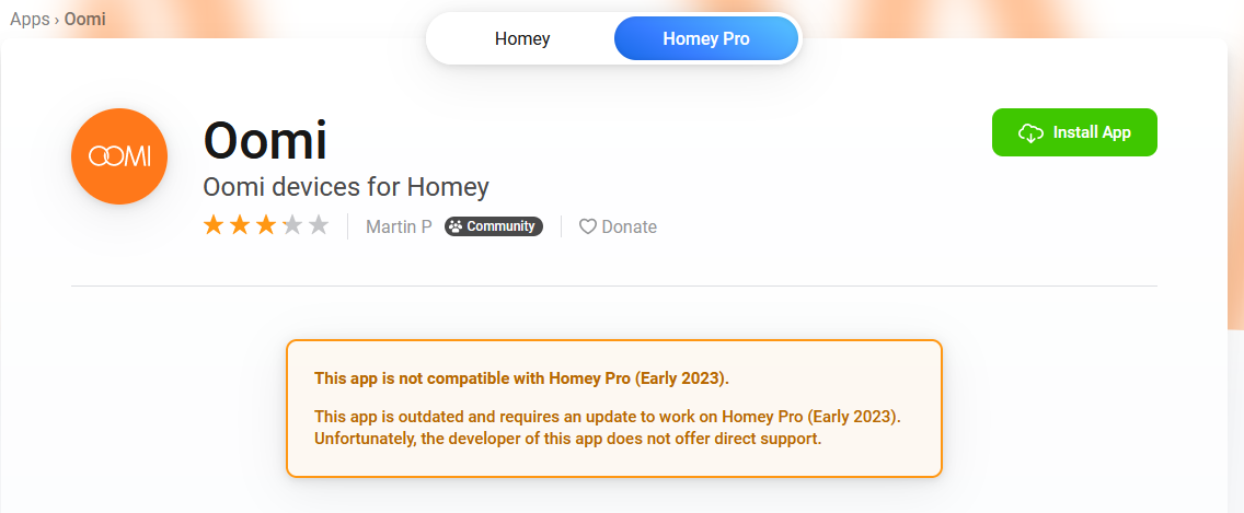

  2. I do have serious problems with adding z-wave devices. Sometimes restarting Homey Pro works. But for the switches I use (OOMI Mote), it does not work at all … OOMi app (not an official one) is outdated, when I try to add it using generic Homey app or Aeotec app (OOMi is rebranded Aeotec), I get an error “unknown command class 254” … any idea what to do? Thanks!
Dont think OOMI is supported then. Never heared of it

It is a normal switch. Works without problems with Fibaro :frowning: It can be used as a generic device. Does not need to be “supported” specifically. Just it does not work with Homey Pro :frowning:
Have you tried to install it using the Homey generic zwave device?
IMG_1526
Really not the same as Fibaro …
Yes, I have tried it. Also using Aeotec app (because this switch is just a rebranded Aeotec one). Both throw an error “unknown command class 254”. What could I do? I have four these switches, they are very good and they are a very important part of my home automation.
Ok ok, might be really nice … if it works. I’m thinking about coding the app myself … need these switches.
Have you reported that to Athom and supplied a Diagnostics report?
I’m not a zwave expert so not sure if that is a bug in the current firmware or just a missing feature, but HP2023 is still very new.
