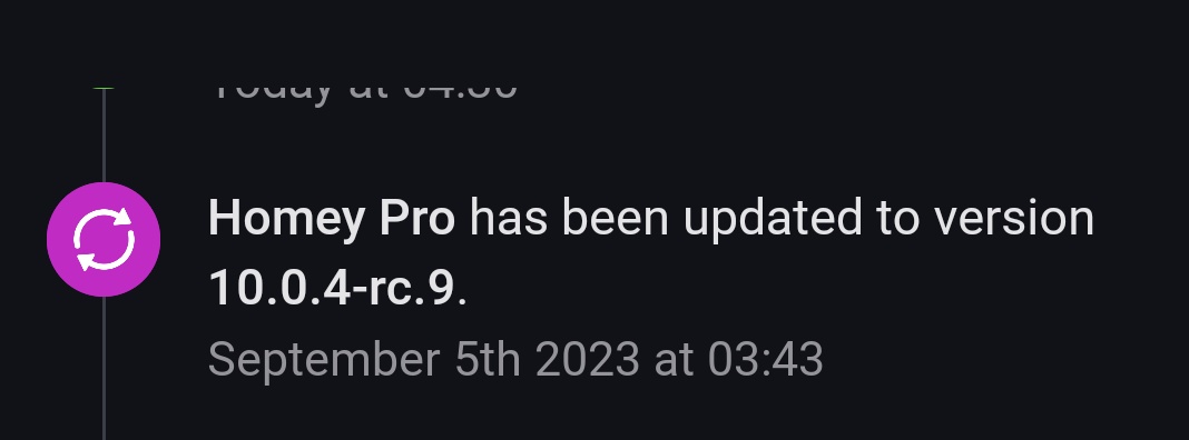

10.0.4-rc.9 is available with much Zigbee fixes.

In case anyone is wondering, the latest release candidate isn’t a fix
What did you expect? The bug isn’t mentioned in the changelog.
I expect that if the bug is fixed in a new firmware version, it will be definitely mentioned in the changelog.
