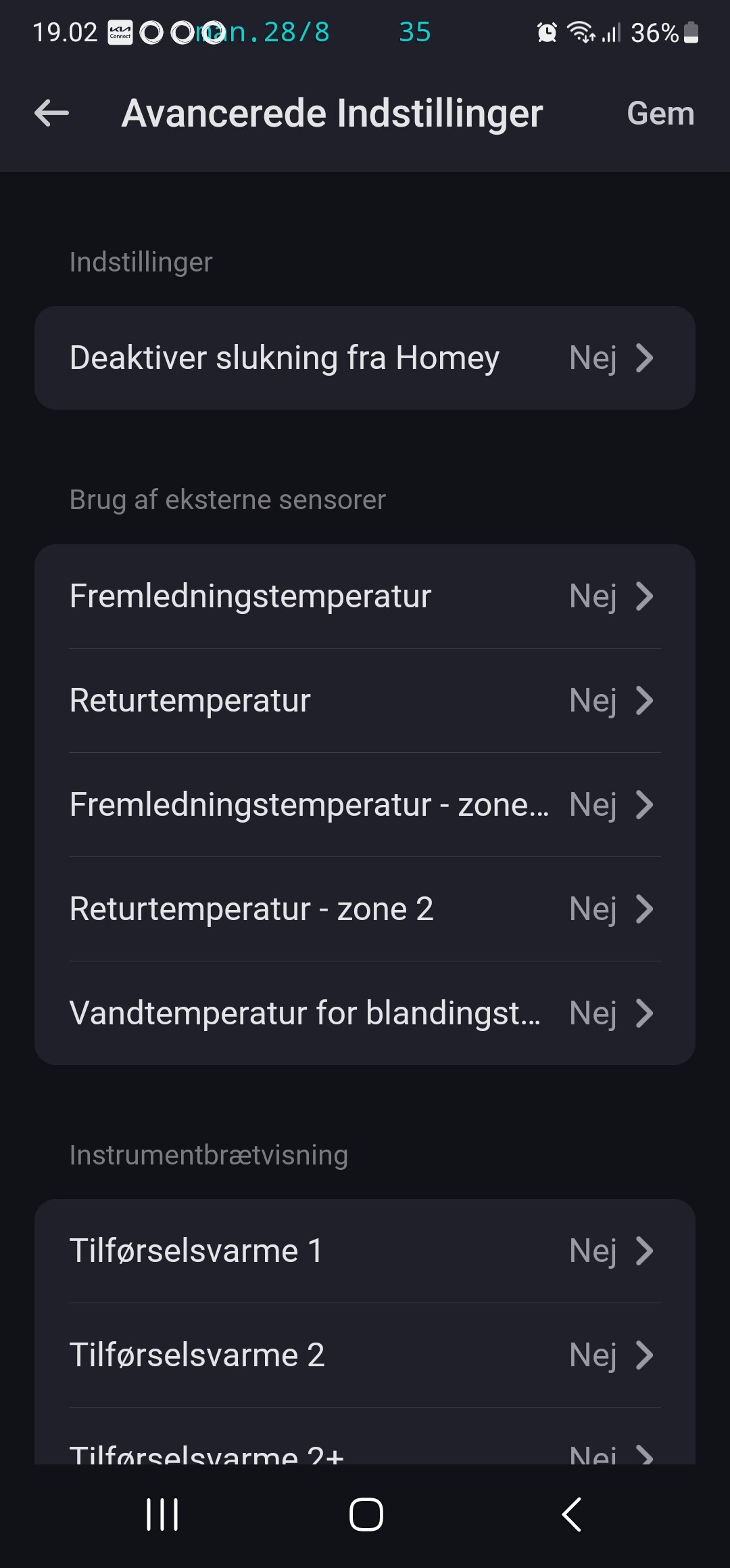

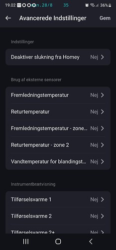

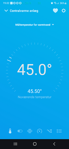

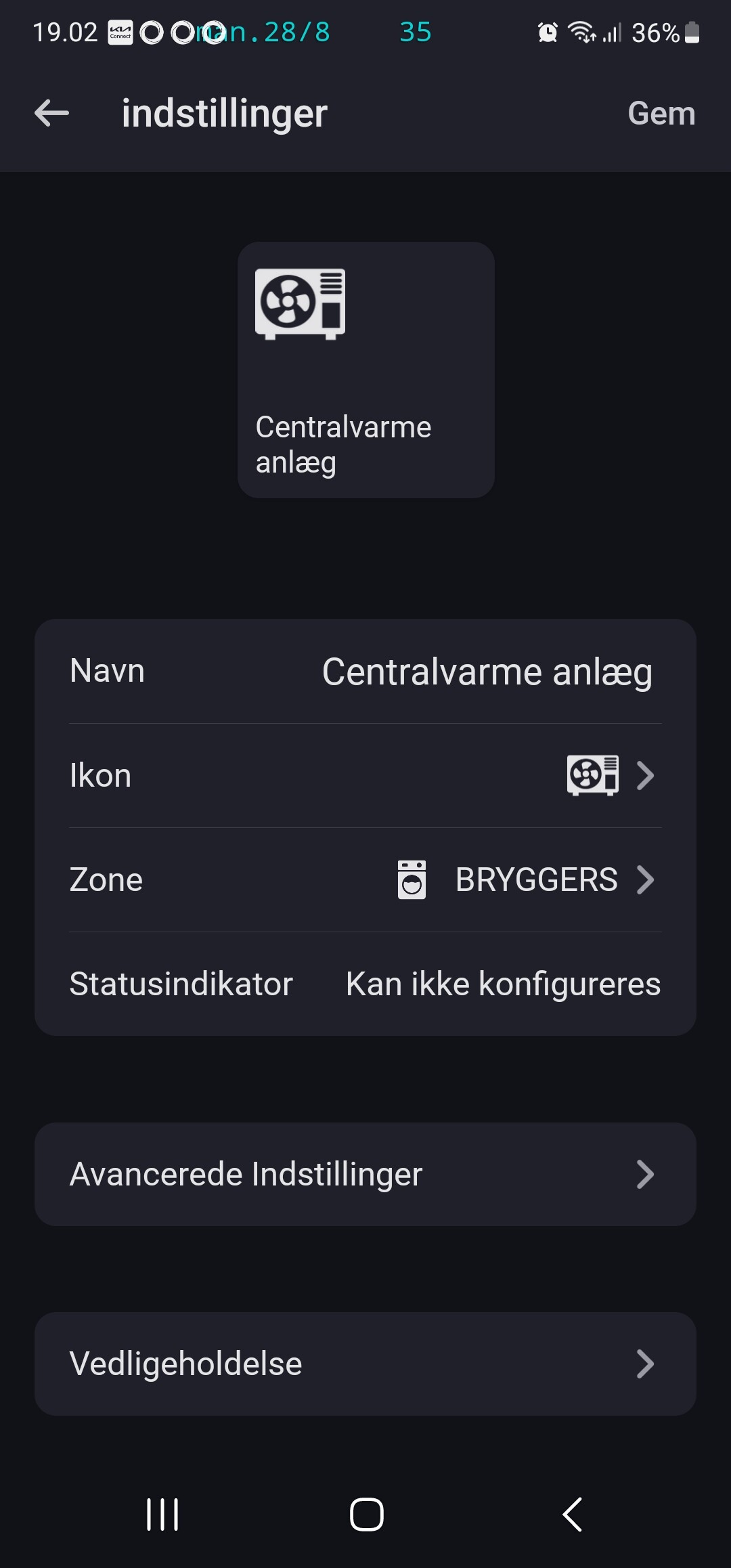

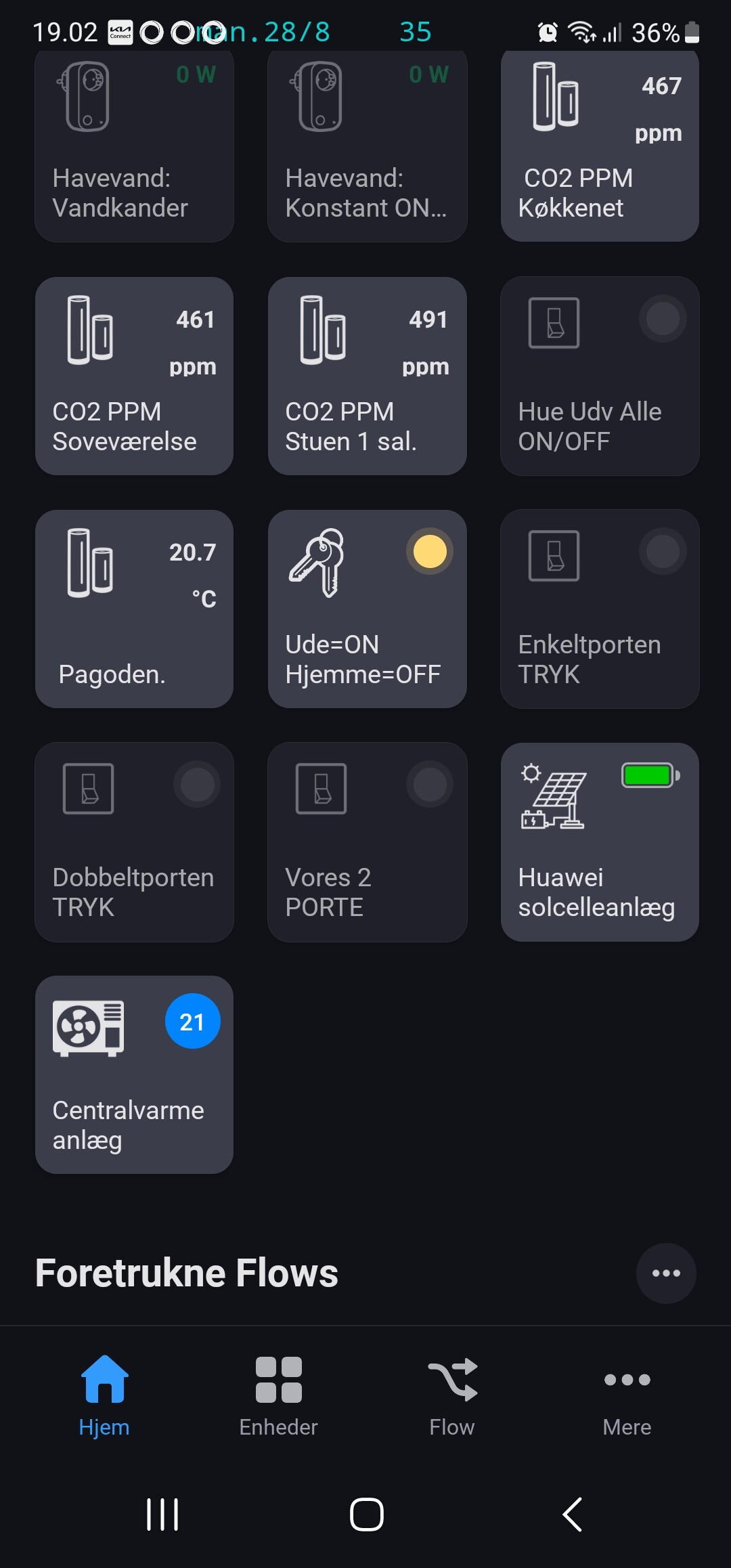

Hello
Since I didn’t have the error: “too many z wave units” yesterday, I chose to do a systematic review of the adjustments I had made since yesterday.
I remembered that in the settings for my Mitsubishi air to water heat pump I had ticked many of the boxes to transfer most of the data from the heat pump to Homey.
After deactivating all data related to the transfer of KW consumption, return, temperature, etc.
the error disappeared and the system works again.
In my case, the reason was too much data transfer between my heat pump unit and Homey.
Maybe you can use my experience.
