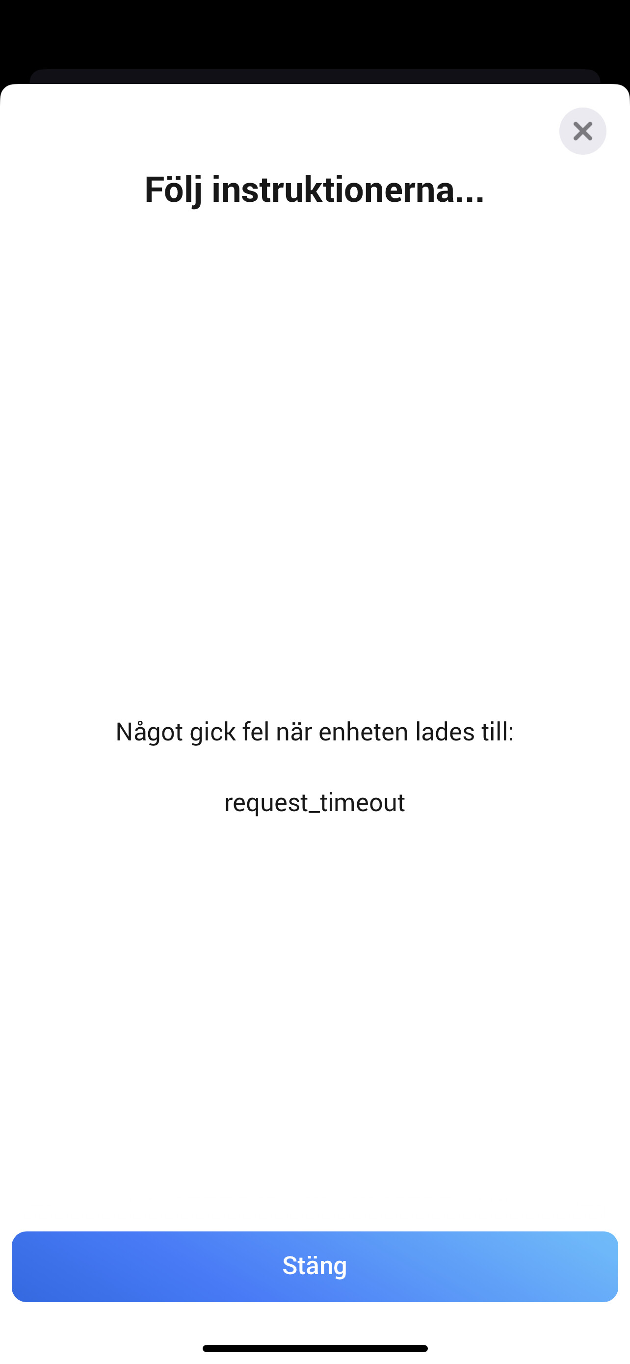

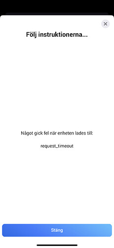

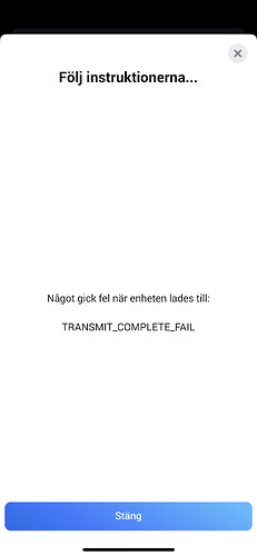

What can I do it’s not working right now can’t add some
Zwave only zigbee I write to the support an they say 1 or 2 weeks I must wait but I bought this for 5000 Swedish krons is not ok
I have the same problem. The only work around is to disable other apps while you do the adding of the new device.
From the phone app click the 3 dots/ More > Apps > then select an app > then click the cog/ settings > then disable the app. Keep doing that with more apps (except the one that you need to add the new device, of course) until the new device pairs properly. Then re-enable them.
Hello thanks for helping me but it’s not working
Not sure what else to suggest. Maybe try turning off all apps except for the one that is for the device you’re trying to pair, rebooting Homey (unplug the power) and then restarting.
In any case, probably worth raising a support ticket as others here have suggested
A send a ticket but it’s long time to wait 1 or 2 weeks
