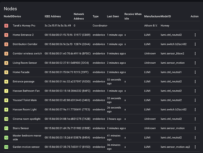

Can you make a screenshot of your devices table from this page: Homey Developer Tools
for a reason the homey Pro is only able to manage the switches near the stairs but when I go deeper on the upper floor it’s not working ! i believe the devices are not working as routers for a reason or another ! even with the homey bridge being in place…
when i configured the homey bridge independently ( not as a satellite and connect the switches to it directly they work fine) but when i add the bridge to the homey pro network ( it has no effect on the range ) I am sure i am misconfiguring the bridge under the Homey Pro

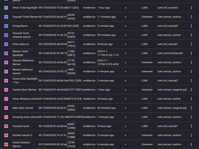

In the column “Type” I only see end devices, no router. Maybe the list is longer?
Except for number 34 they all seem reachable, see column “Last Seen”. You can verify per Zigbee device by clicking the ping command behind the 3 dots.
They are probably all no-neutral devices (that, or Homey is misidentifying them as an end device, which is something that seems to be happening with the HP2023’s for some reason).
In any case, I think we found the reason why the network isn’t working properly: no routers (but at least we now know that the new Homey will accept at least 40 directly connected devices :joy:).
@Tarek_ElRaey your network is extremely unbalanced. You need to add (at least) 5 to 10 proper Zigbee router devices if you want to make this work reliably across your entire house.
Yes I agree this is also what came to my mind. They are all no neutral devices which may be causing the issue.
