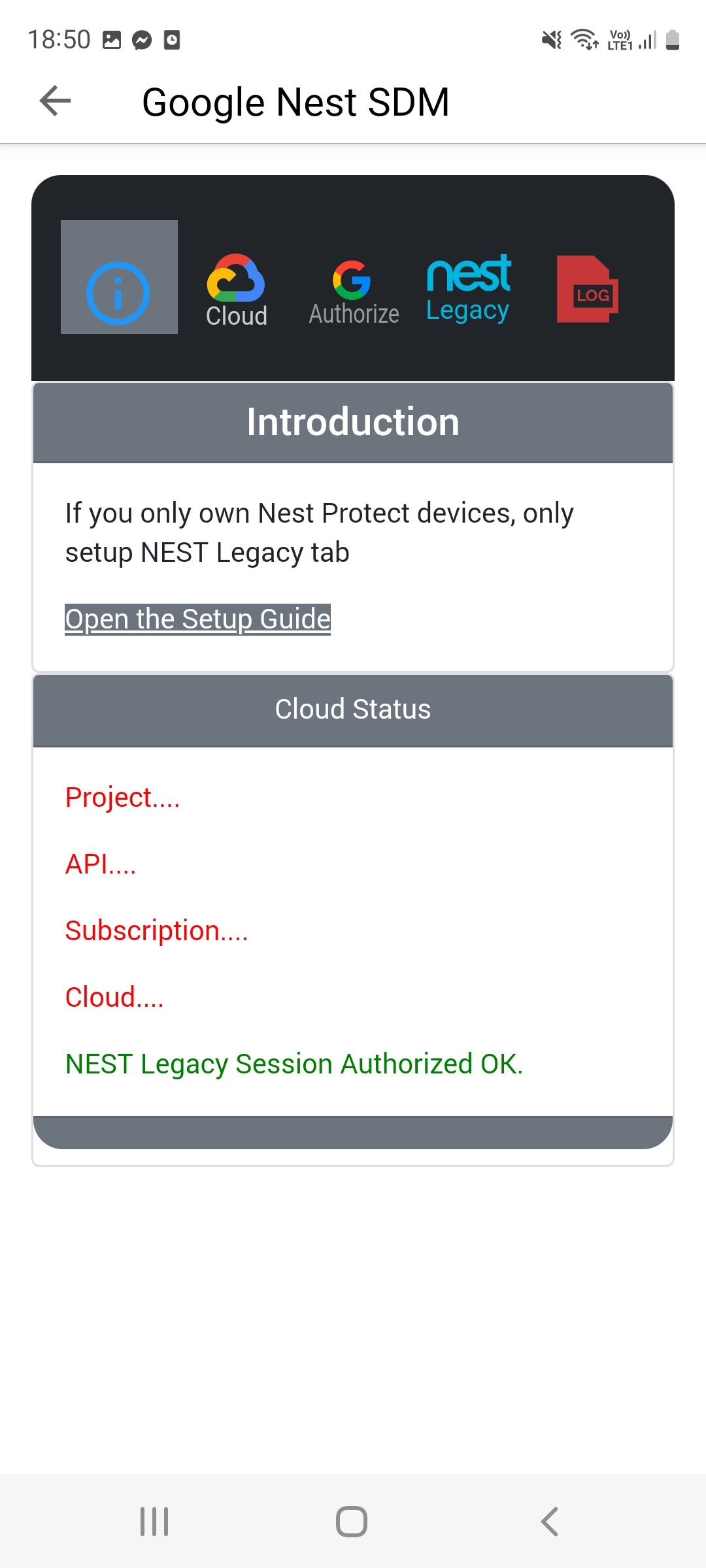

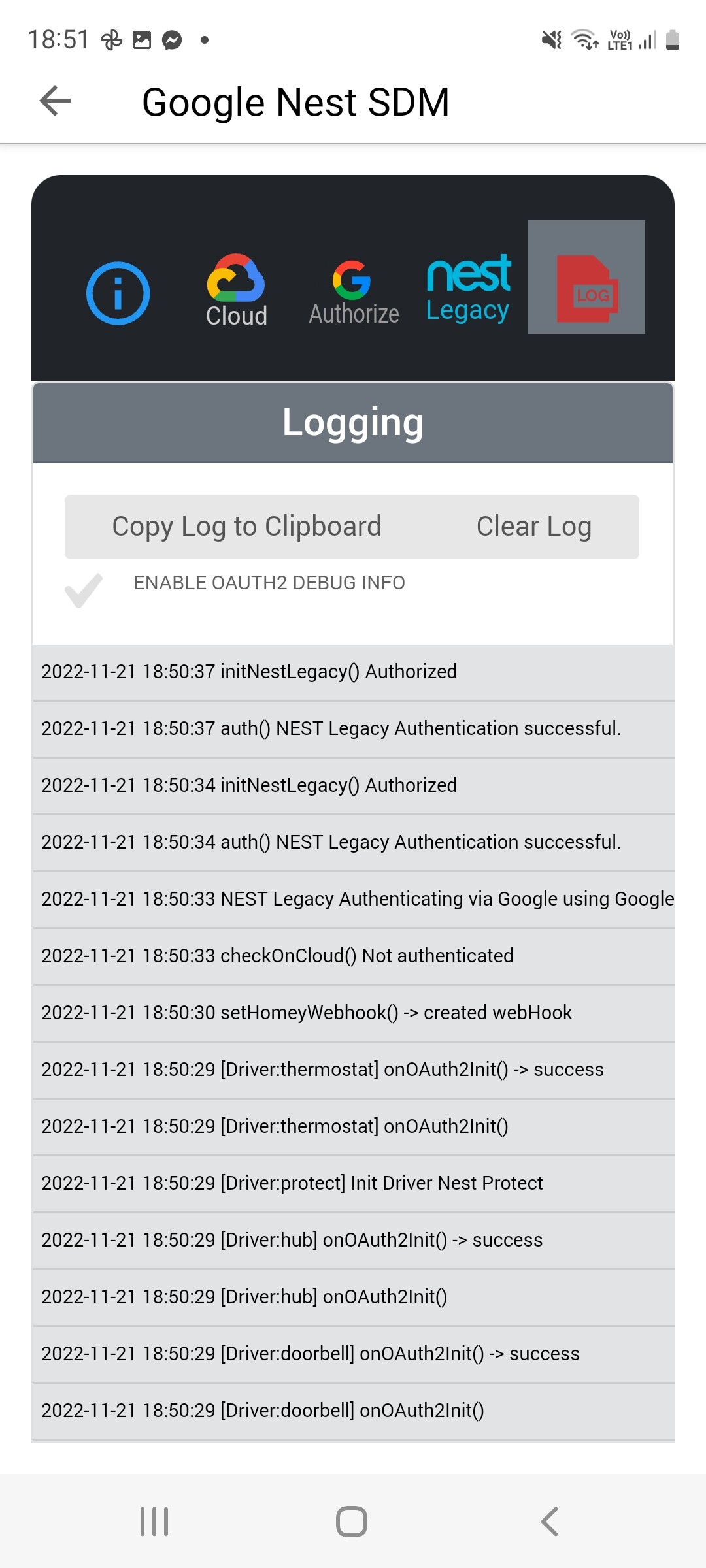

Ive done that, as I explained above.
When i save the session, nothing happens, though the log states its authenticated.
Shouldnt the nest legacy tab change so I get a “request” - button?
In my case, my only option is to save session, Even thought its been confirmed.
How do I proceed after saving session?
Nothing happens.
If you go to the first tab and it is green for the Nest legacy status, try add the Nest protects. If it fails,please pm me the log so I can check what the issues is. Thx
What tab?
Ive screenshoted the info-, nest legacy-and the log-tab. Theres nowhere to add anything? Check my screenshots.
