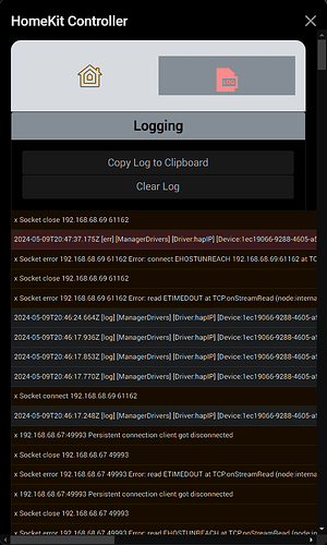

This keeps on happening, causing my lights to do nothing. Right now the app is pretty much useless.
It’s not like the device itself is useless, i can connect just fine using the Aqara app. HomeKit Controller however keeps hitting a brick wall with the closed sockets.
Any ideas on how to fix it?

EHOSTUNREACH is caused by an underlying network problem, so I would suggest checking the state of your network and/or Homey’s network (for instance, Homey’s WiFi is notably unstable).
Always the best way to set static IP is to do it in the DHCP server that normally is in your router, if you have a cheap network it often don’t support this.
I have a Homey downstairs and upstairs and this device with the EHOSTUNREACH is upstairs. Does Homey switch automatically between the devices when sending a signal or should i select the Homey to use per device to have the best results? I can’t find such a setting on the device itself.
You can only have one Homey to interact with the device. It sounds like your upstairs Homey might have issues with its networking.
I’ve assigned static ip addresses for the devices now and will monitor them the upcoming weeks using the logs from Homekit Controller. Hopefully it improves.
After clearing the log and rebooting the app it still see some socket errors tho:

Perhaps messages like these are okay though @Martin_Verbeek. Are they just an attempt to connect or do you consider these errors?
x Socket connect 192.168.68.69 61162
T
those are okay,
Just a warning.
