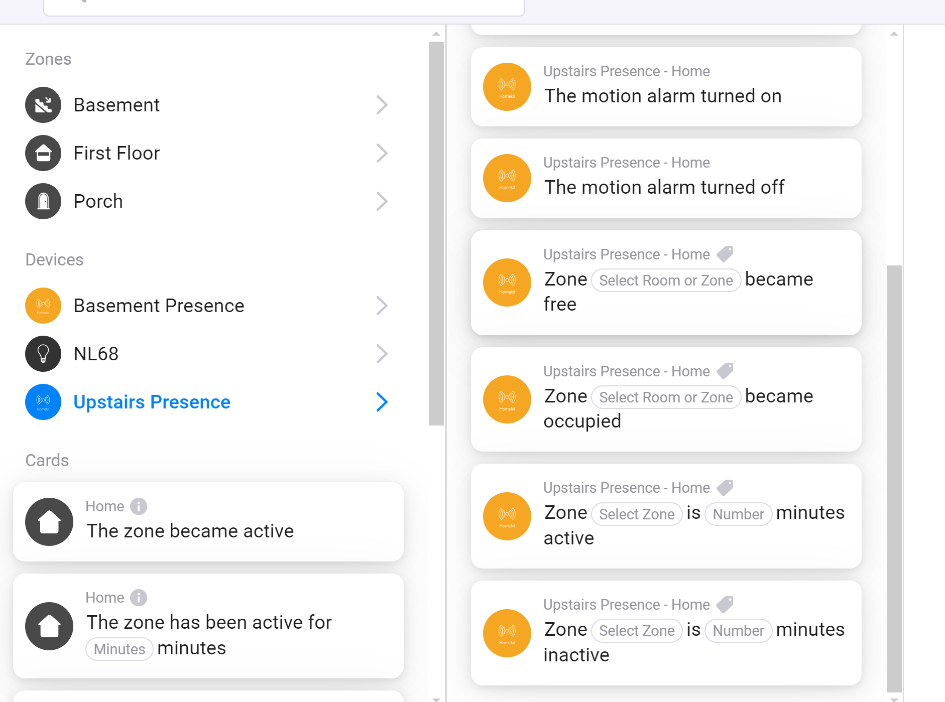

Has anyone had this happen with an FP2 before: My flow on my basement presence was not working, and when I went to the flow it said “card not available”. Well it turns out one of my two FP2s now has fewer cards available. See the screenshots of the difference in cards with the sensors. I made sure they were both up to date, and even removed and re-added the basement one that had less cards, but still no luck. Anyone experienced this before? I can no longer have it trigger an event after zone becomes inactive after X minutes.
Do you have at least one zone defined?
I had the same issue and the zone occupied card appeared after I set at least one zone.
You were correct, thanks for the recommendation! For some reason the default detection zone on the FP2 wasn’t showing up so I created a second zone that covered the entire room to replicate the first zone and then they both showed up in the Homey app and the cards appeared. Appreciate the help!
If you have no zones, it should just show standard Homey motion detected cards. Though in the FP2 case it will be presence.

Using these cards myself in a number of rooms without issues. Can you trigger occupancy / no occupancy according to the aqara app in a room and PM me the log? Thanks!
move for room occupied/free to the standard motion alarm on and off cards (without zone naming in it) this will trigger room free/occupied. For room active/inactive you can also use the standard Homey active/inactive cards for these.
For specific parts of a room (FP2 zones) use the zone cards…

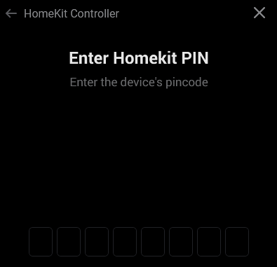

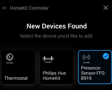

Posting for other folks here if they search for setup or Android with the FP2. I was able to get this working without too much effort. I was worried after looking around that I’d have to use MQTT, Home Assistant (HA), or worse some other hub to integrate. That’s not the case and only Aqara App and Homey are required. My steps were:
  • Install the HomeKit Controller App on Homey
  • Remove each FP2 sensor already setup in the Aqara App
  • On each sensor hold the button for 10 seconds to reset (This may not be needed, but did it anyway since my sensors automatically re-entered pairing mode after removing them)
  • Add the sensor back into the Aqara App as before. If you had any previous zones setup, you may want to remove them because the names will not get saved upon adding to Homey, but if you recently setup the zones and know the order it’s probably fine since you may have to rename the zones in Homey.
  • Go to Homey App, add a device, select HomeKit controller, HomeKit IP → Connect.
  • If everything went well you’ll see your sensor and any other homekit compatible devices listed (See attached).
  • Choose your sensor and you’ll be prompted to enter the pin (See attached)
  • If it’s successful your sensor is ready to go for flows
  • From there you can open the device settings and rename the zones if you want so they show up in the HomeKit flow cards correctly.
Hope this helps someone else out :slight_smile:
