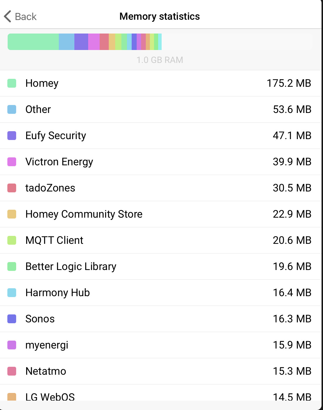

Checked
None of my installed apps are using any memory.

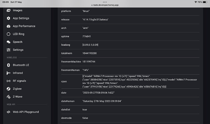

So with Homey doing absolutely nothing it has 14% of memory available.
The old Homey memory stats aren’t correct, they don’t take into account the amount of memory used for caches/buffers that can be made available for apps when required.
My old Homey is doing nothing and only has 3% free:
By disabling ALL apps and removing ALL zigbee, zwave and 433mhz devices managed to get free memory up from 14% to 15%.
Which according the the spawn ENOMEM error message there is not enough memory to run any apps or devices :slight_smile:

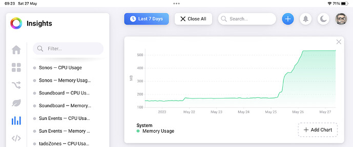

Just performed a hard reboot with a 60 second power out.
See if that helps…
It looks like Homey just decided day before yesterday that it needed all the memory to itself and stopped doing anything.
It looks like the hard reboot has fixed it.

When you look at Insights, that seems to be true, but on the other hand the Memory Statistics (…more>settongs>general) do not show memory for disabled apps.
I was trying to build an app once, removed all of it, but Insights still shows 6MB after 2 years :woozy_face:
Or the Http Request app, it has two entries!:thinking:
In my opinion the Memory Statistics shows the real current RAM use.
Insights is just not removing the leftovers / updating inactive apps.
My apps & memory overview (40 active apps):
