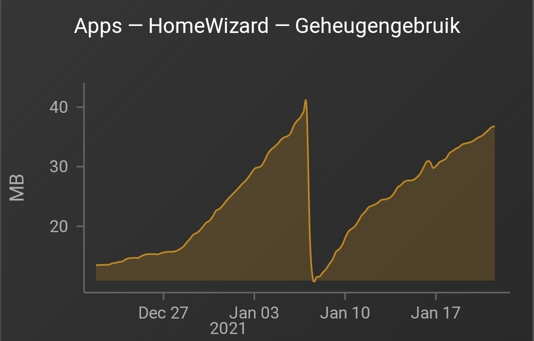

New beta release for better connection handling (timeout issues when Homewizard has bad connection and errors with socket hangup or failure). In these cases the JSON payload is wrong as well and makes the app increase in memory. Hopefully with the AbortController npm it will work better.
Let’s hope so, not sure if it’s related. But the app increases a lot in memory every day. Let’s see if it’s now less or is it unrelated?

@rvdeijk Thanks for your log you are on 1.1.16 so that is one.
What I also see is a lot of timeouts between Homey and Homewizard:
" message: 'Response timeout while trying to fetch…" which is a 5000ms (5 sec).
Also with the result that the body is not there hinting:
“ReferenceError: body is not defined
at /includes/homewizard.js:123:54
at async Object.module.exports.homewizard.call (/includes/homewizard.js:99:26)”
So in short you have a wifi connection issue with Homewizard dropping/causing timeout issues.
When even a timeout of 5000ms would also make the every 10 seconds poll and issue and to me this is a reason for high memory usage.
My word of advise is to see if you can improve the wifi with Homewizard (move the unit elsewhere with hopefully better reception. Further what you can do is grab the latest version, (source code) increase the polling from 10 to 20s and install it via CLI. Or I can provide you one that already has the increase polling cycle. I am working on a version where you can adjust it in the settings rather than it is hard coded.
Yes but I was on 1.1.12. I updated to 1.1.16 when I made the post with the screenshots.
Hmm okay. Thanks for notice. The weird part is, that homewizard is 20 cm hanging above the router (rt-ax88u). So maybe It’s too close :thinking: and have to place it a bit further away :laughing:
Yeah 20cm can be an issue. :slight_smile: Mine is about 3 meters away from the AP (Ubiquity).
This is my memory log (higher numbers are upon start a new version/developing).
I have the router and all network devices (switch, connexoon), under the stairs (middle of the house). All is wired, except homewizard. I will try to find a better spot. Is 1m far enough?
Homey is in my living room. Same weird choice as Homewizard, to not have a proper RJ45 connection. Who made those weird decisions, to have a home controlling unit that relies on wifi, especially the crowded 2.4GHz…
