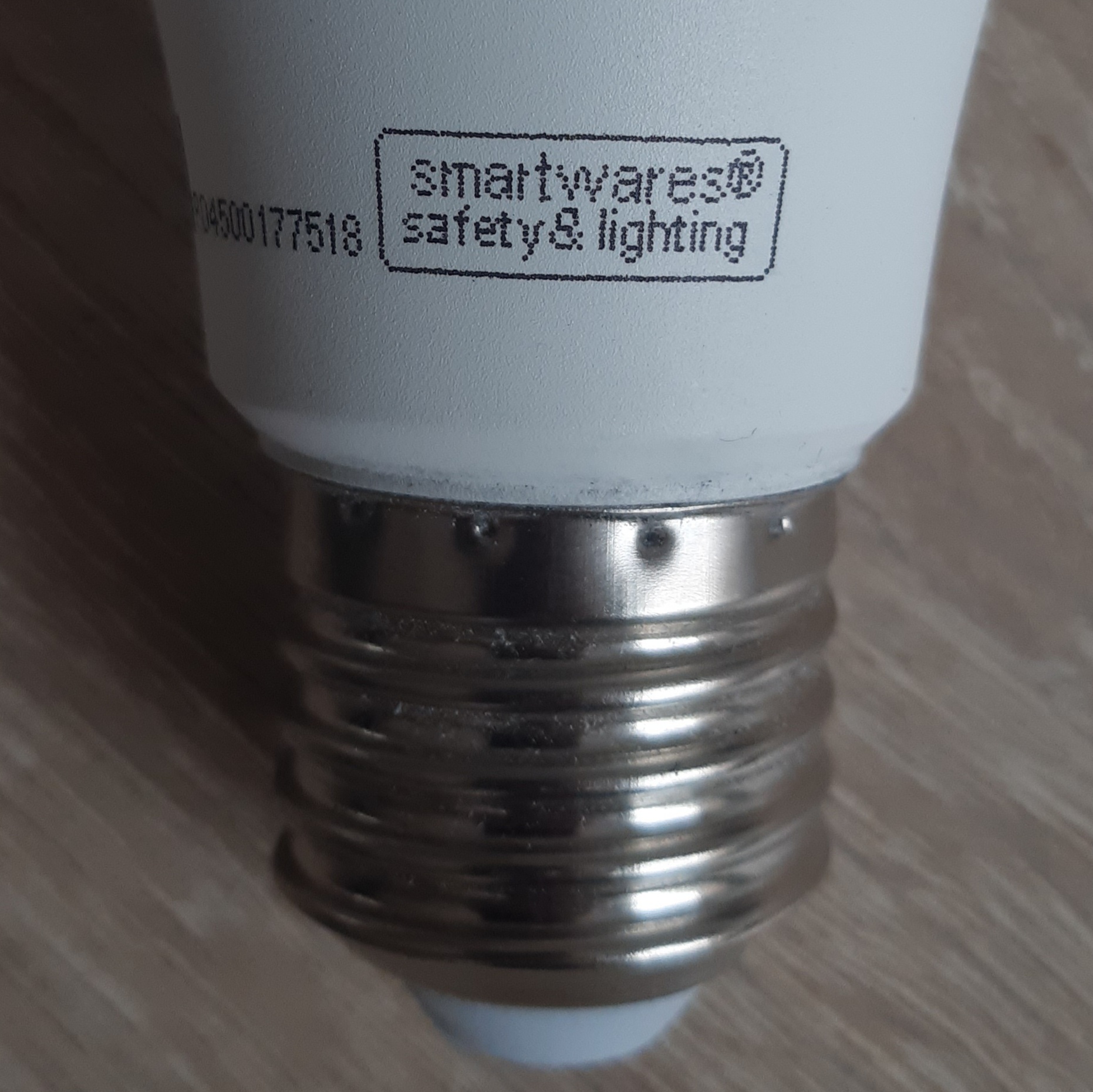

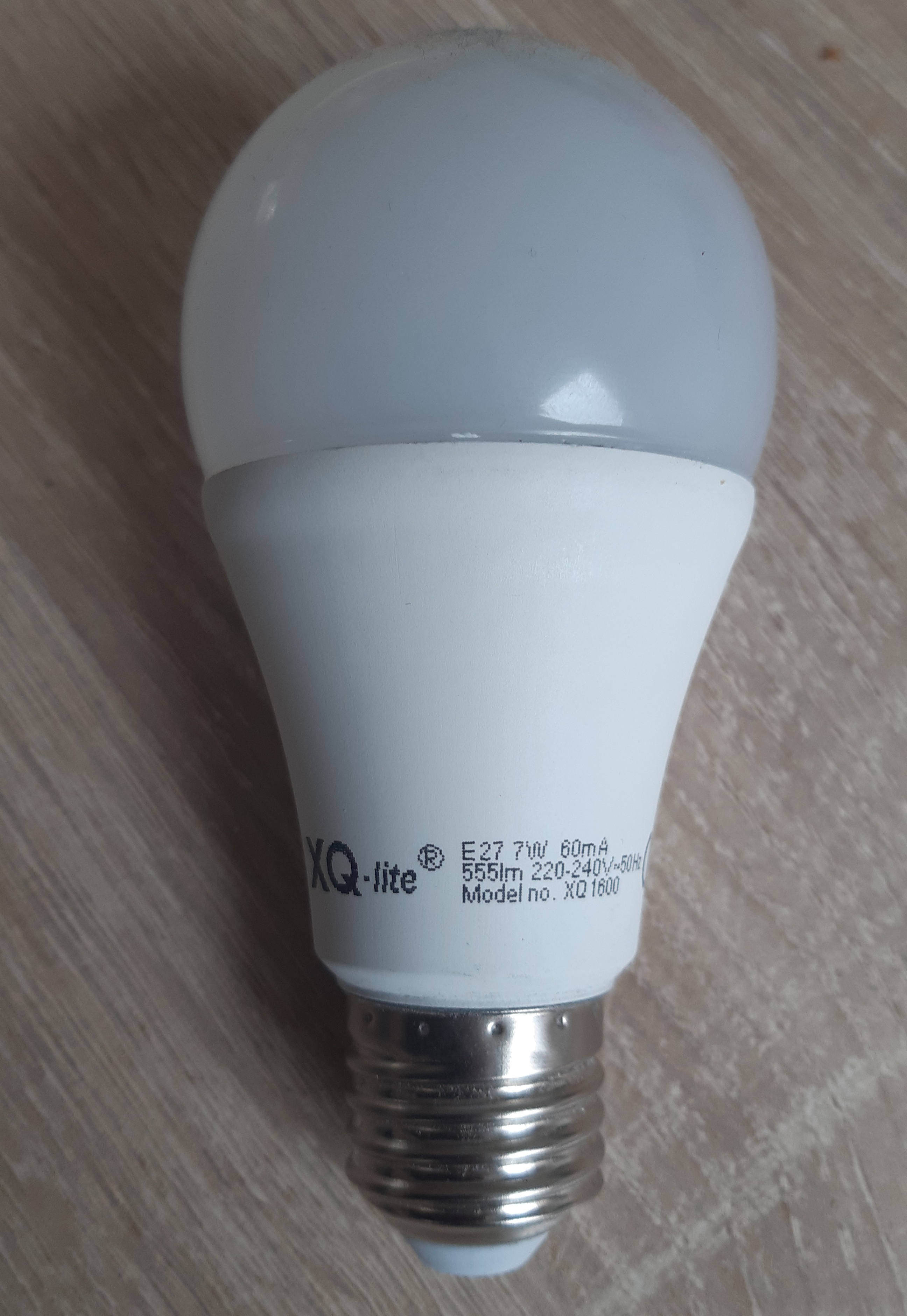

Lately you implemented smoke sensors 433mhz as well as the Cavius 868mhz version.
Is it also possible to add Smartwares XQ-lite 868Mhz connected LED lamp XQ1600
If not I will probably replace this light one day with a Philips Hue version.
Everything is possible but getting a bit chunked with work lately. I will put it on the wish list and see when I can. It’s a little more complex compared to the sensors (one way). The lights are 2-way (get/set).
I also need to look at some performance improvement. Some of the code is synchronic vs async that might be the cause of some of the delay/responsiveness.
Thanks, no hurry.
