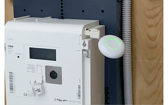

Would it be possible to integrate the new P1 Wifi “dongle” into the app as well?
And would you still have to use a HomeWizard then? It connects to WiFi, so…
The price is very friendly too; only €29,95
https://www.homewizard.nl/homewizard-wi-fi-p1-meter
Currently working on a separate app for it. Code is nearly same as the current Homewizard app but like it to be not integrated at all. This new dongle does not require the old Homewizard so try to keep it separate. It is only a bit difficult because I dont have it myself and depend on the API they have which is still “beta” and hard to test without owning the dongle myself.
That is good news thx!
So only having the new P1 Wifi dongle would be enough? No other hardware or paid HomeWizard account or things like that?
If there are more interested users we can perhaps sponsor you so you can buy one…?
