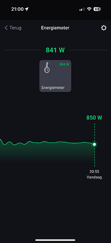

the energy button in the homey dashboard DOES show the historical data :frowning:
but only from 15:00 today

HomeWizard v3.3.25 - Homey pro E23: 12.2.1
It really is a hit and miss. Very strange. Yes sorry Willem, rough long day at work so missed that. Think something goes wrong with the grafana (?) cluster. :thinking:
Yet it works ok on older homey pro 2016-2019 like @Peter_Kawa.
So then it is not a bug issue in my app as I cant make/do a difference in hardware. So my gut feeling makes me think its a firmware issue.
the what cluster ?? :wink:
No worries, no need to apologize, the sun is down and no results from the panels anyway… So I’ll start the laundry and the dishes by hand :wink:
Lol well I dont know the exact magic behind it but the graph tool(solution) seems going wrong on some metrics on a Homey Pro 2023. As it seems ok on the Homey pro 2019.
Will that break my flow as well ??
No, your flow should not be affected by insights. As long as the value still changes on the device this must work. Insight should also take that value and plot it, but that seems to me be broken in the last homey firmware for pro 2023.
