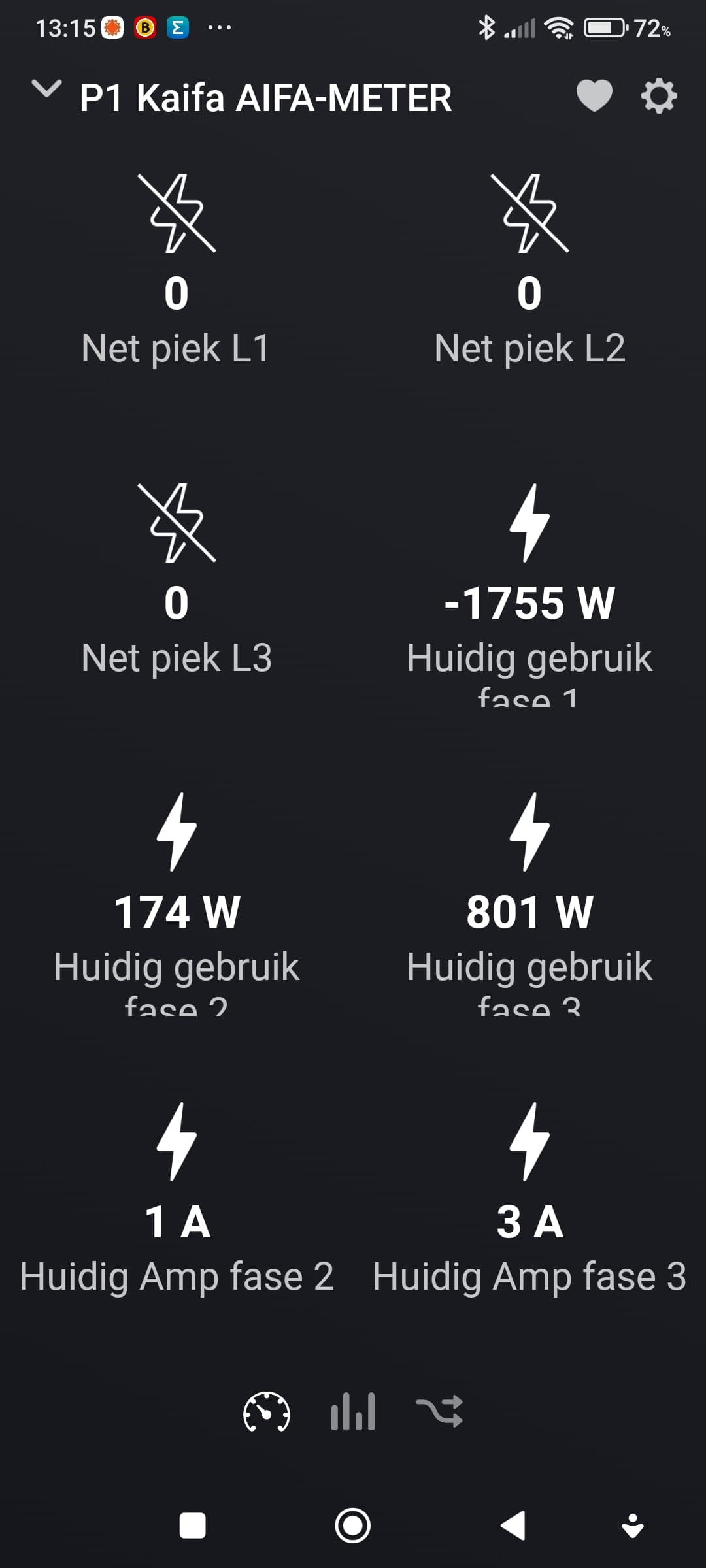

Hi there, is it normal that the current from fase1 is seperate from the fase 2 and 3 they are not grouped together in the overview screen in my Homey.
Best regards Peter.
Yes blame Homey for that. It’s a bit of a problem about the order when capabilities are added/removed. Sadly no alphabetical order or personal order/sorting people can apply.
