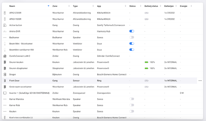

I had to add more devices based on IP adress, that did work (The below list is about 50% of the devices I’ve added to Homey Pro)

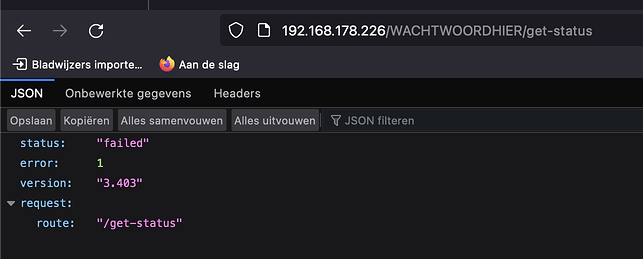

This is the result I get:
Is this helping to find the root cause?
Where it says “wachtwoordhier” you need to fill in your own password of the homewizard locally… so not the one from homewizard online!

Is that report showing anything that is unusaul?
Its the method used to get the data from Homewizard.
Status says failed as your password is wrong of course.
