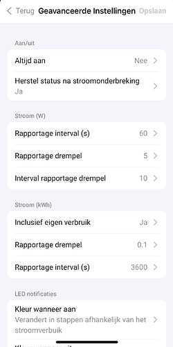

Hi! Is it possible to report the power usage when the power plug is turned off.
Now it is 0 watt but in reality it must be something between 1-2 watt. When having loads of these plugs this is relevant.
Thanks!
I understand the reason but honestly the measure is about what is plugged in the socket. There are users that have a flow checked if usage is 0 and if I starts to add 1 watt for every socket this will become a mess as their flows wont trigger. Moreover I dont see other sockets do the same to compensate this own socket power usage like Neo, Innr or Shelly etc.
Partly true, I see fibaro doing it in its dimmers and power sockets.
But indeed neo not and this gives me at least 15 -20 watt of discrepancy if I compare my smart metering with my homey.
Maybe I create a virtual device (all sockets) and add up all the power these use to get it right :slight_smile:
For fibaro it is an option:
Let me think about this one. It’s a lot of work to add this to compensate this 1 watt per socket (conditionally).
