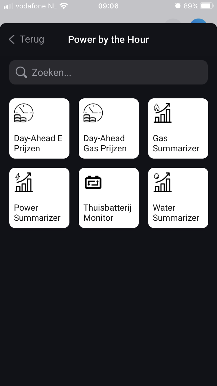

Yes use Power by the Hour
i don’t find it, do you have an example?
yes i have install them but cant get further than this
First you must add Power by the hour device based “summarize” power/energy of your P1. When that device is added you can use the calculated value of kWh of the day. One note is it starts at 0 kWh so it need to run for a full day.
Ok i understand.
But i don’t have a P1.
i have sockets and 1 fase kWh meter
Then create the summarize device from those.
But the whole problem is that they haven’t these tags
Maybe that can be added?
No I can’t as the Homewizard sockets and kWh meters don’t have that information locally. Hence you need the Power by the Hour app to do that for you.
Add power summerizer:
Select your socket or kWh from there.
Thx got it.
