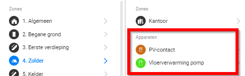

Hi @Jeroen_Tebbens,

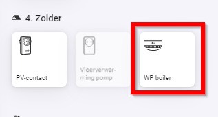

Hi Jeroen, yes with the web GUI it worked to a the water overflow meter.
2023-03-23 14_34_58-Homey 2023

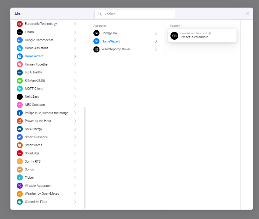

The strange thing is the device is not avilible for selecting to us it in a flow.
2023-03-23 14_36_45-Homey 2023
Can you see what is going wrong?
THX!

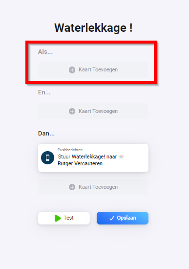

Either refresh or what do you expect it to trigger then? Those have a generic alarm.
Hi Jeroen,
Ik wat to get a message when there is a water leak.
Click there, then homewizard app, then that water sensor as generic alarm not?
Nope, it is not there.
Hm kay, I’ll have to investigate my code then. :expressionless:
THX! please let me know if you need more info.
Succes!

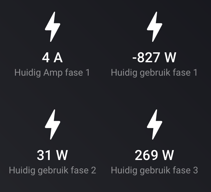

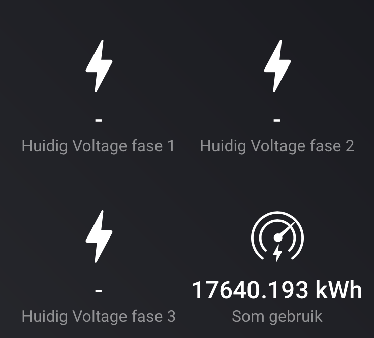

Hi @Jeroen_Tebbens,
I still can’t see voltage info with my P1 meter. I have 3 fase. Should I re-add the P1 device after the upgrade (didn’t try this yet)? I restarted both Homey and the P1 meter already.
Thnx for your help.
Guess your p1 firmware isnt updated?
Try http://ip-address-p1/api/v1/data
Hmm I don’t get any Voltage outcome. So properly wrong firmware then…

I thought the firmware on the Homewizard P1 is automatically updated? I just disconnect the P1 from the meter, remove the power source and then powered it again. But still no update.
Or is the firmware of the smart meter (Landis + Gyr) outdated…?
I see no active_voltage_l1_v etc…. Soooooo no volt info from your Smart meter unit sadly. You do got the other details of the new firmware so your Gyr Landis unit does not provide voltage info atm. So not Homewizard to blame but your Gyr Landis is the problem here,
Ah, thank you for the check!
