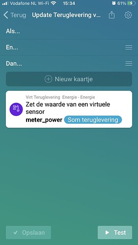

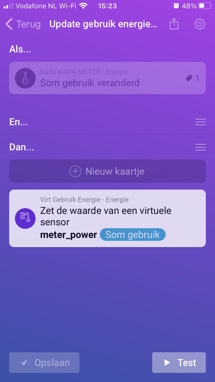

Note on the new meters.
You can now create a virtual device (sensor - energy meter) and “copy” the value (import or export energy) and then create a PBTH device to track it.
Hint:
And then create a PBTH of this virtual device
Same for export (solar)
Then create a “netto” virt device (sensor - energy meter)
And add a flow with this calculation of the PBTH sub meters for “day” kwh.
Netto calculation usage = kwh this day (import) + (solar day kwh - kwh this (exported) )
The export kwh from PBTH doesnt include the instant used energy from your solar panel generated energy hence you need to deduct that from the overall solar panel generated kwh.
