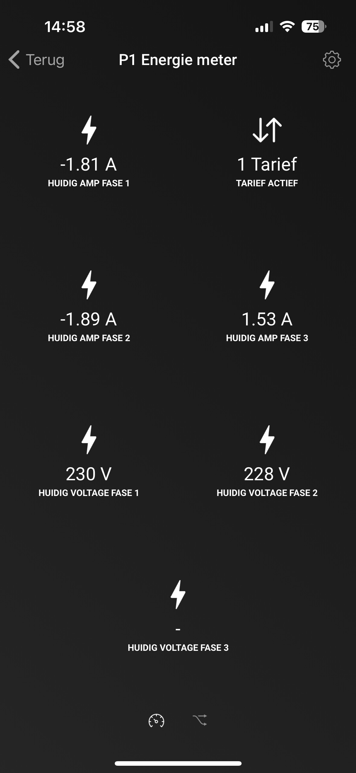

@Jeroen_Tebbens how do you know when you have an 3 phase or 1 phase connection? I see my 3 phases in my Homewizzard Homey app and the amps of phase 1. but not voltage.
I’m on V3.1.3 homey app and P1 firmware 4.14
I see the problem, capability check I do is on an existing value so its skipping the voltage meters. Will change thatvin the next version.
Great, Thank you! And maybe if we can see the amp of the first phase, are they also available for the other 2?

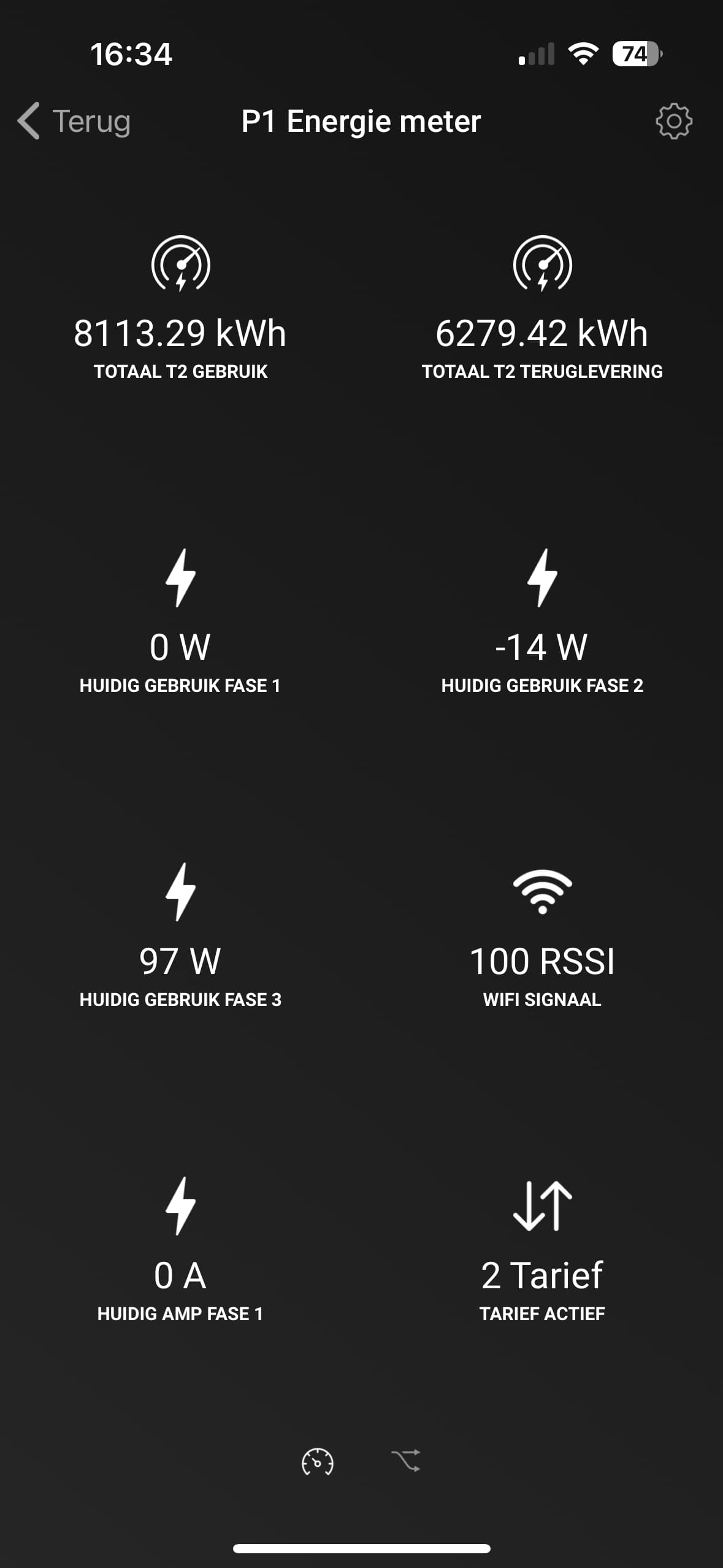

Is there a way to hide the Amp phases that aren’t used and give no value?
They should be removed by the code, weird. I dont have them. I will check
Try v3.1.5 @Henk_Renting
Thank you for updating so fast :clap: everything works great only the voltage value fase 3 is not reporting.
Yeah I see a typo in my code.
Yep, working! Thx @Jeroen_Tebbens!
