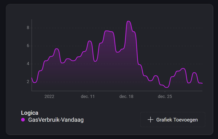

My P1 meter logs the cumulative gas usage.
Is it possible to see gas usage per day preferably in homey insight.
I can export data and do this manually. However, direct availability would be nice.
Use the Power by the Hour app for that.
I do it like this:
I have two number variables.GasVerbruikTotaal (Total gas usage) and GasVerbruik-Vandaag (Today’s usage). At the end of the day I subtract the current gas (total) consumption from the gas consumption of the previous day. Leaving just the amount you’ve consumed that day. After that (10 seconds) I reset the “GasVerbruikTotaal” with the current value so I can use that the next day to calculate the day consumption.
Note: Of course you can only calculate the day consumption at the end of the day, so the graph lags one day behind. (25dec is actually 24dec)

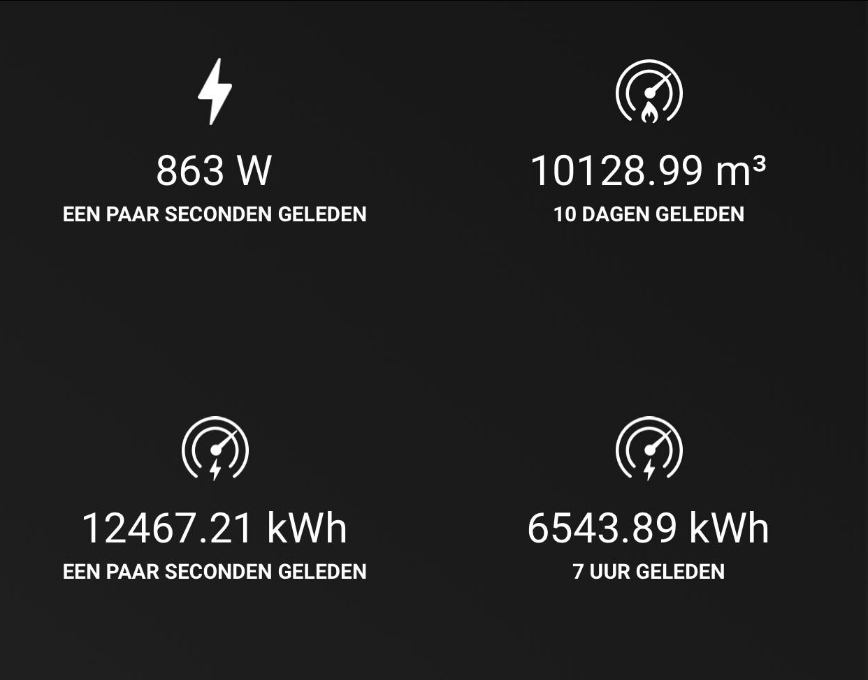

Hi @Jeroen_Tebbens ,
Somehow my total gas consumption got stuck on an insane amount:
A couple of day’s ago the gas consumption suddenly jumped from 375 m3 to 10128 m3 inside the app. And got stuck in that position. As far as I know I didn’t start a large Steel furnace factory. :rofl:
According to the app the last gas update was 10 day’s ago, but all the other information (electricity) is a couple seconds ago. In the Homewizard “energy” app it shows the correct value (425 m3).

Yup sounds like you had another gas meter before and due to the new firmware of the P1 the old gasmeter got assigned back to the datapoint I pull.
Means your energy transporter responsible for your “slimme meter” didnt remove the old one.
Yes, about 5 months ago they replaced the gas meter (and electricity meter) over here. But after reinstalling the Homewizard sensor everything worked fine until 10 day’s ago. For my understanding, you are saying that a new firmware on the Homewizard sensor messed with the data the homey app pull’s?
What can I do to resolve this issue?
Call those gas meter guys (Stedin, Enexis, Liander, etc.) to remove your old gas meter from your slimme meter registration. The P1 dongle will then report the correct one back via the Local API.

Nope it will not fix that problem. Its in the slimme meter.
