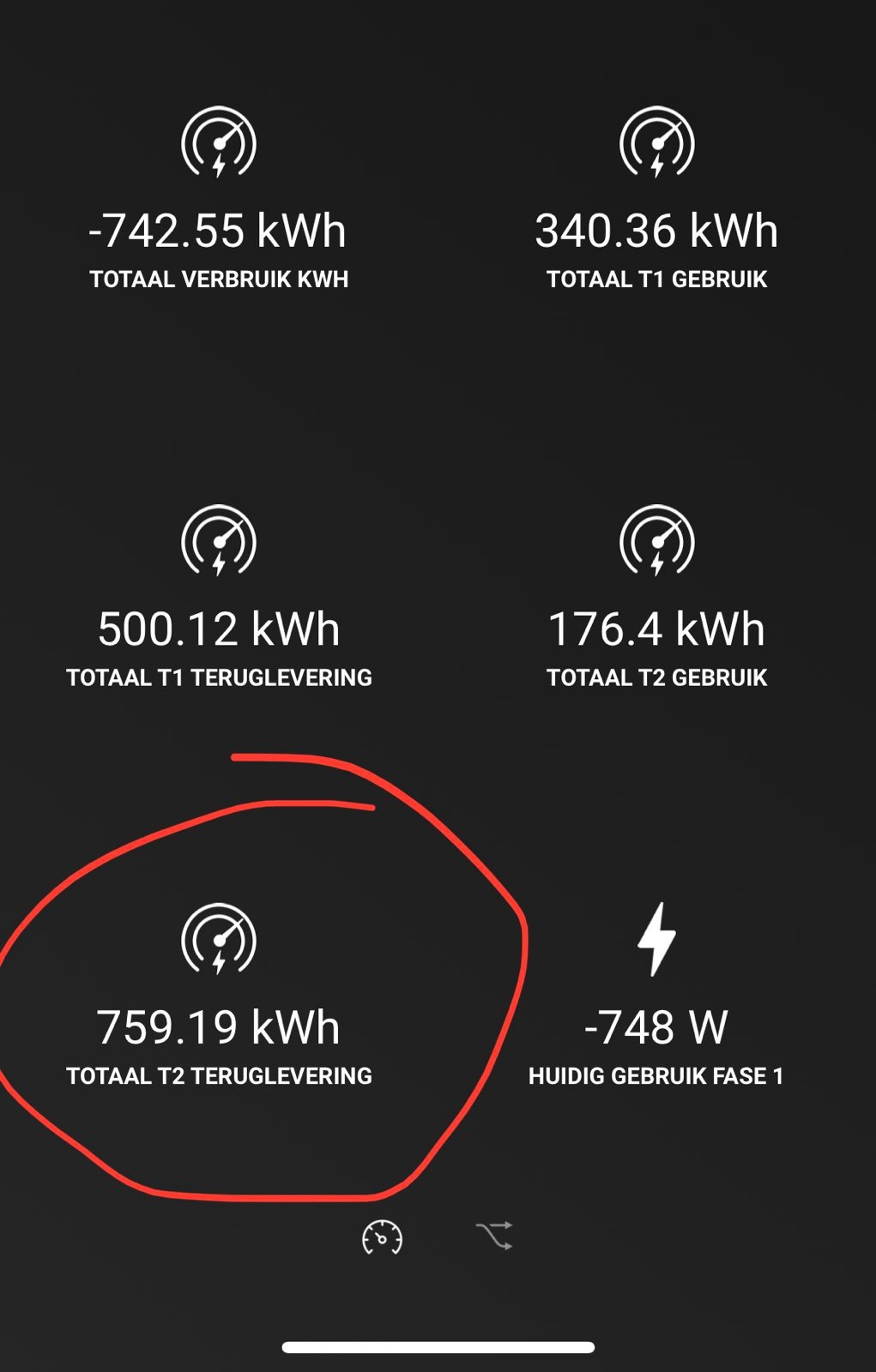

Hit diagnostic again. Btw you are 100% sure that meter was negative before? You’re were not mistaken by the W value on the lower end right?
Maybe check the insights webpage and show me the graph where it was negative on that value.
https://insights.homey.app/
Then select your P1 meter and share the graph of your “Totaal verbruik KWH”
Yes 100% it was negative. After summer I had even more than -1000 kWh because of the PV system. I’m looking for screendumps from that time, but not sure if I made those.
I deleted the meter and added it again, so it looks like my graphs are not there anymore…
Found one!
Ok so there is the -742,55 kwh Totaal Verbruik kwh I wanted to see to be sure it does go negative.
All the other T1 and T2 will be positive. Still no error in the diagnostic.
Let me see if I can get a test version which should handle the new output better related to the new firmware as I am lost now why it doesnt update.
Beta / Test version 3.1.0
  • New P1 features firmware (Peak/Normal & Dag Nacht tarief)
  • Bugfix for Total Usage KWH / Totaal verbruik KWH
  • Tariff changed trigger card added (untested)
Bingo!
So in short an unfortunate side affect of code I implemented for Sweden Energy P1 dongles kicked in for Netherlands as well. Which didnt subtract the T2 from imported energy (sweden has no T2). This has been fixed now.
