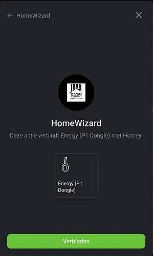

Ik ben een nieuwe gebruiker van zowel de P1 en de watermeter. Ik wil beide apparaten in HomeyPro toeveogen. maar dat lukt me niet. Ik hoop dat iemand me hier kan helpen!
Did you switched on the Local API in the Homewizard app?
This is the English part for the Homewizard.
Yeah did that…
And you’ve read all instructions in post #1 as well?
Upon pairing do not press the P1 button as described. It must stay solid green.
That’s happening. I restarted the Homey Pro, and now I get them into the list!

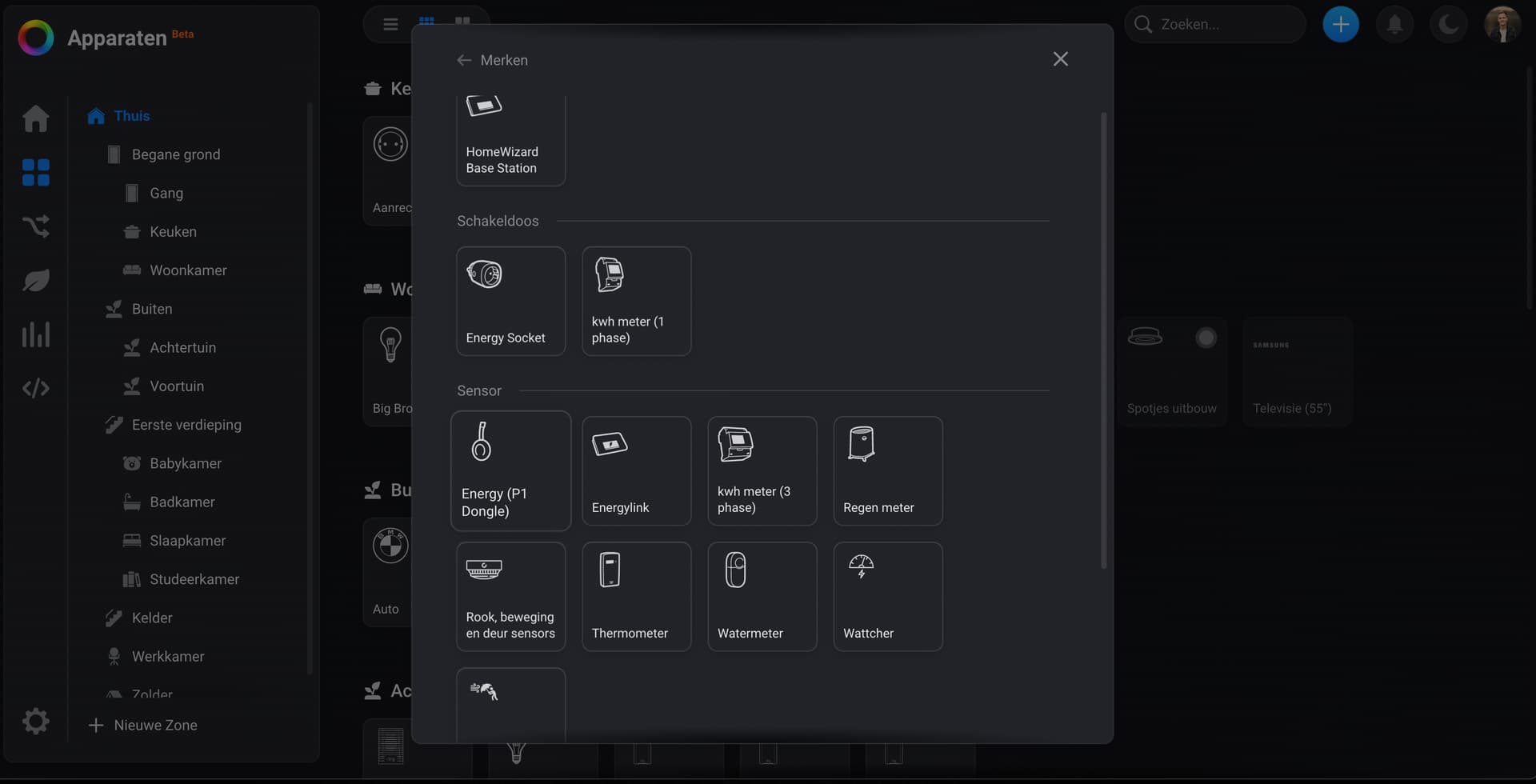

Hi.
I have an issue with Homewizward.
I have a P1 Meter and 2 Kwh meters. I am able to connect them and view them in the Homewizard app on my iPhone.
I am also able to add the P1 meter to homey, but can’t find the Kwh meters. I have resetted my Homey and now first tried to add the kwh meters and that was a succes, but now the P1 meter is not discovered within Homey.
The API settings are enabled.
Does anyone have any idea?

Ok just to be clear you can see these devices in your Homey but have a red marker as unavailable?
No, I can only see the Kwh meters and they are working fine.
When I try to add the P1-Meter the app is unable to find it at all.
Ok must be mdns problem, please install a mdns discovery browser as mentioned earlier in this forum channel. Check to see if you can find .hwenergy etc
I did, I am able to find the record.
API is Enabled
