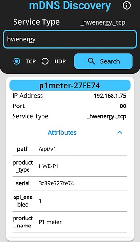

@zakraket please get yourself a mdns browser to see what is going on.
Apple/Iphone/Ipad
Google/Android
And search for:
_hwenergy._tcp
yes, I unplugged it for >10sec (I don’t have/need a USB adapter)
edit: using mDNS Discovery finds the P1 meter @ IP 1.187
Homey reports (on the device “page”): Device not available (Forbidden)
Literally in Dutch: Apparaat niet beschikbaar (Forbidden)
and does it also have api_enabled=1 when you click on it?
No, it doesn’t, how can I change that?
In Homewizard Energy app, go to meters, P1 device and scroll down to toggle Lokale API switch to on.
You must have turned it off hence Homey is not allowed to use Local API features (forbidden).

  • Install mdns discovery app on your iphone/android and check for _hwenergy._tcp and see you can see your devices there.
Hi Jeroen,
Yes they are and always were in the same Wi-Fi network.
The P1 power meter is found by the mdns app (see attachment).
The two other powersockets I have are not found by the mdns app.

So if your sockets are not there but your P1 is then there is a multicast issue. What is your internet router? Do you use pfsense or opnsense by chance? Further your accesspoint(wifi) do you multicast settings thst could impact that?
It’s strange to me as this 3.0.8 is worked in test for almost 2 weeks with 50 users testing no issues, hence pushing it to stable and you hit this.
Now over 3400 users with P1 are on this version so if it would be my app giving issues I excepted more crash logs or people asking.
Because the P1 power meter was found by the mdns app, I tried to add it to homey and that succeeded.
So next I tried a power cycle for the power sockets (unplug and plugin again) and voilà they are found by the mdns app and also by the homey.
