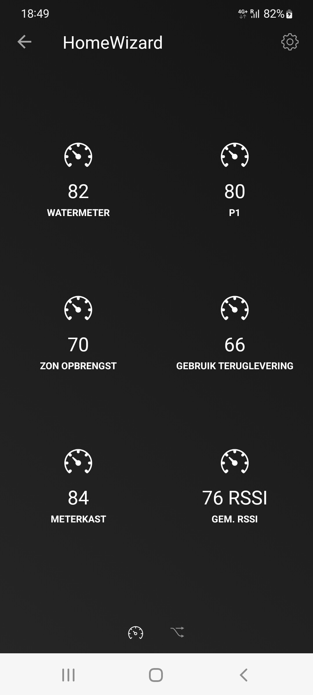

@Jeroen_Tebbens Here’s a screenshot of the app AVD from @Arie_J_Godschalk It shows some of my HomeWizard devices so that I have an overview of the RSSI and an average. I still need to fine-tune this a bit, but it’s a start.
Both thanks
Ah ok, didnt know that app yet. The wifi strenght is a % and not a noise number (goes negative). Homewizard API has strenght in % where 100% is perfect signal of course. :sweat_smile:
