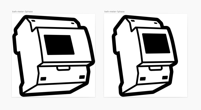

Totally different thing… I’ve made some device icons for the kWh meters. Are you interested in implementing those?
https://basvanderploeg.nl/uploads/kwh-meter-1phase.svg
https://basvanderploeg.nl/uploads/kwh-meter-3phase.svg
Sure can do!

  • Updated icons for kwh1 and kwh3 (credits to basvanderploeg)
Works like a charm! Thanks! :tada:
Thx pushed it to certification so it will be live soon.

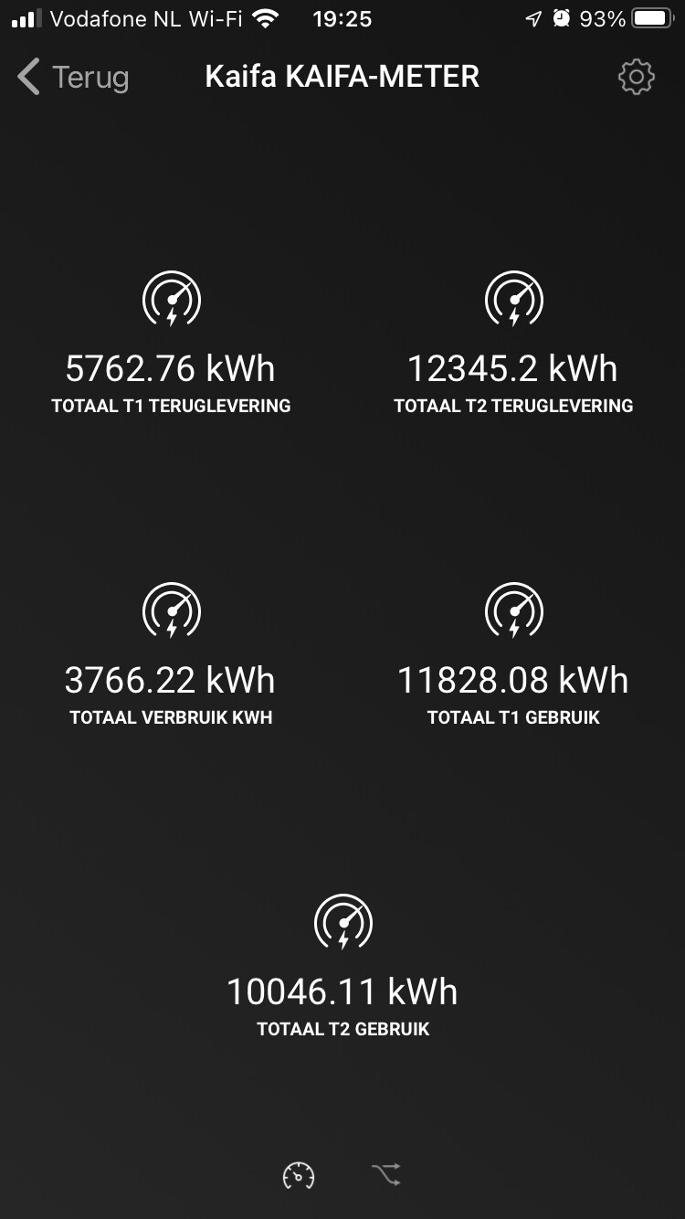

The app provides the usage data (total_power_import_t1_kwh and total_power_import_t2_kwh) from my Homewizard P1 dongle - but local API also shows total_power_export for t1 and t2. Any chance to have those in the app as well?
It does that already.
Interesting. I’ve reconnected the device to Homey but no dice.
Any thoughts?
