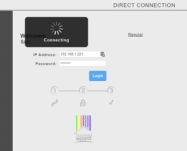

Logging in by the browser seems not to work:
Did you change your wifi / accesspoint recently? To me it sounds like if Wifi Clients are not allowed to talk/communicate to each other over the same wifi.

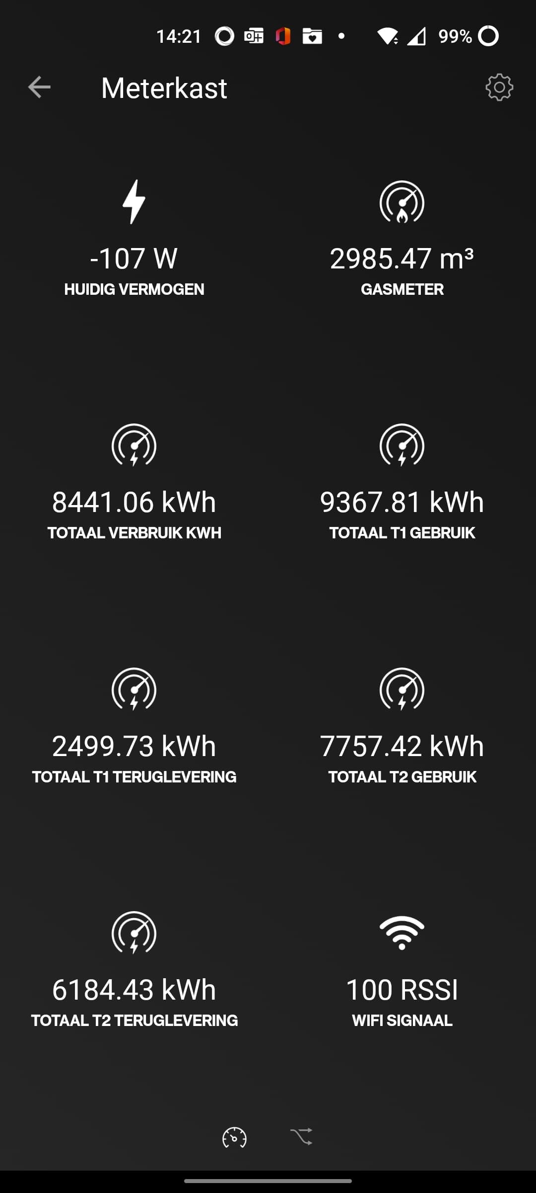

Yesterday my meter changed from a Fas1 to a fase 3. When I had the fase 1 I had 4 meters
Totaal T1 Gebruik
Totaal T1 Teruglevering
Totaal T2 Gebruik
Totaal T2 Teruglevering
A day later I only have
Totaal T1 Gebruik
Totaal T2 Gebruik
3 meters have been added: For all 3 fases a Huidige Verbruik…
But I have Solarpanels, how can I get de T1 and T2 teruglevering in Homey…?
Jacob
Did you remove/add your p1 on your smart meter? Also could you restart the Homey/Homewizard app. If no change than we need to check what the p1 shows in its API and I can then verify it with my code. This type of cases are not easy to troubleshoot. Changing from a Fase1 to Fase3 with keeping the same device in Homey is not a daily task.
I’ve got a new meter, so yes… I have removed and added it, I also deleted the P1 from my Homey and added it to Homey, but still the same result.
I didn’t removed it from the Homewizard app: Energy… But I don’t think that will help because I can see alle 4 meters there.
