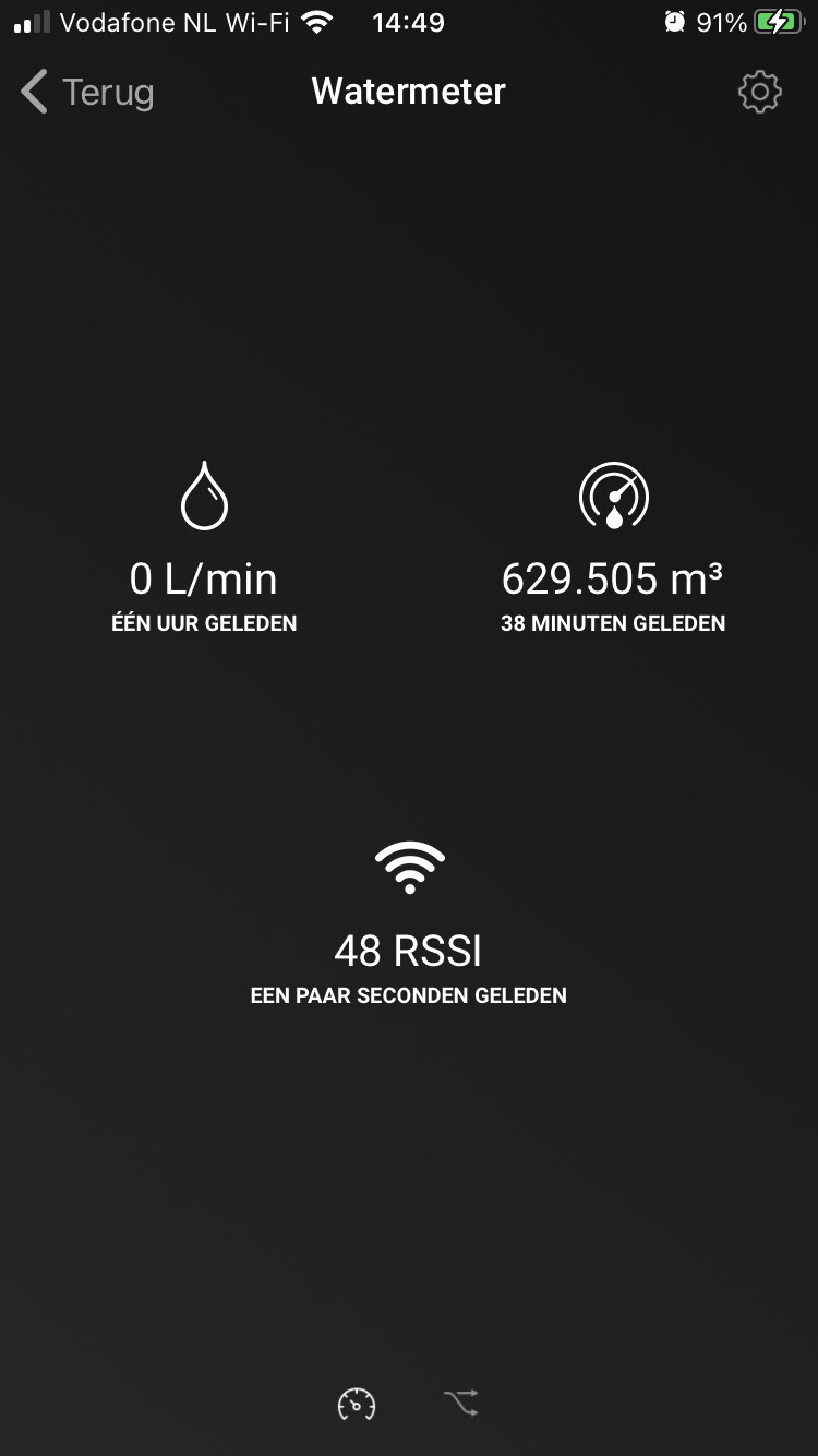

Today my homewizard water sensor and my electricity sensor stopped working with homey. In the homewizard energy app they are still available and working.
Reset and reconnect does not work. Do your devices still work? It seems an app issue.
Thanks for checking!
Watermeter is fine here. Check your internet router. Stuff like mDNS (multicast) is mainly cause of problem.
Further check accesspoint that clients are allowed to talk to each other (Homey and HomeWizard WiFi devices).
