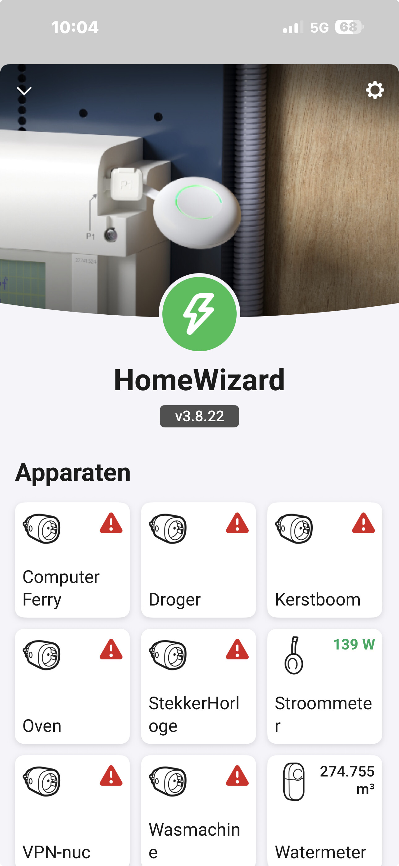

After update to 3.8.22 all sockets are disconnected.
Kind regards
Ferry
Sorry to say but pretty sure your wifi is the cause of that.
