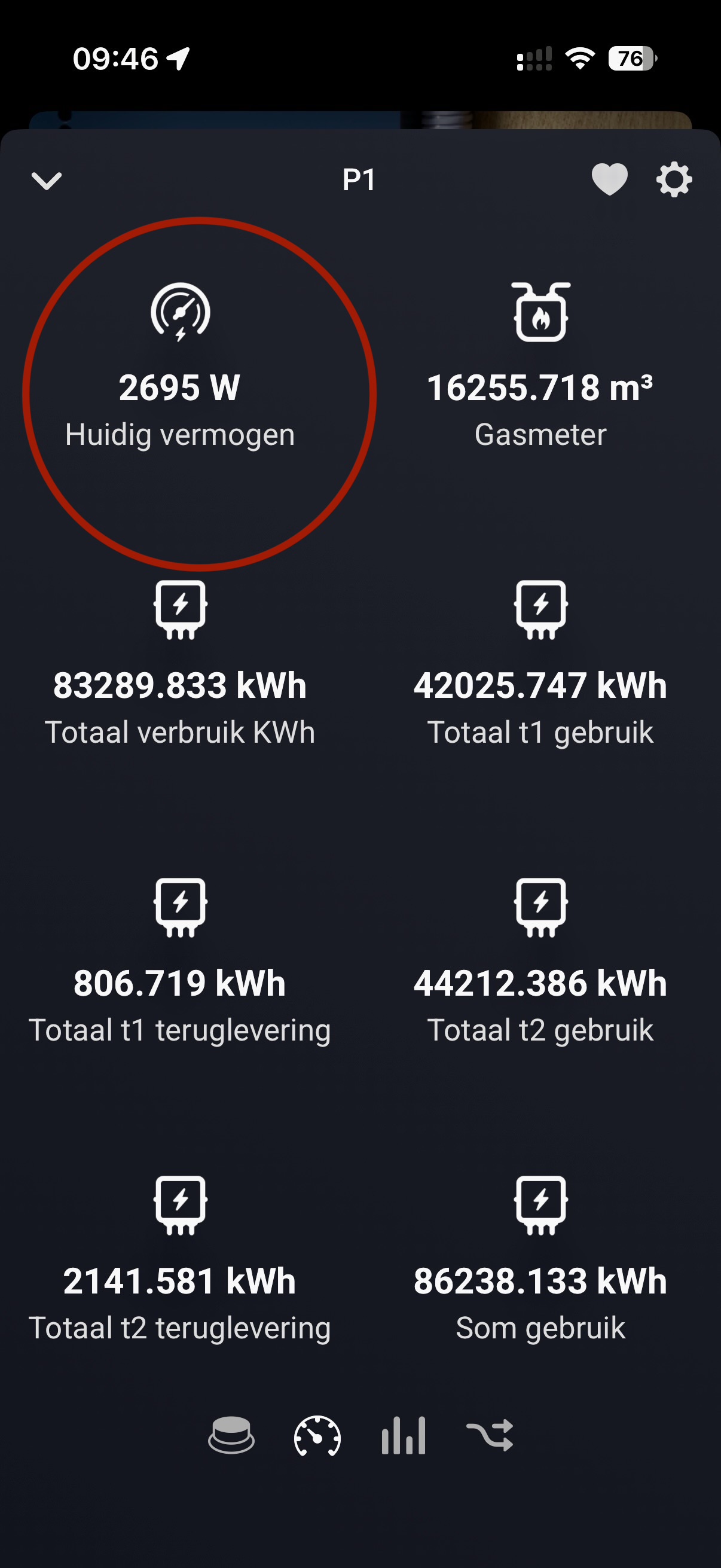

I have an issue with the P1 meter freezing in Homey and the only thing that helps is an app restart. I made a flow to do this automatically and report back and it happens at least 2 to 3 times a day. I’m not sure if it’s a HW issue as they seem to be having a lot of server problem nowadays but just reporting it to see if maybe other users experience the same. I’m on 3.8.18

The power use freezes.
Homey Pro with 12.9.0-rc.14
Could you share me a diagnostic report after that happens?
My guess is wifi stability issues on your end. I see no other reason why that would happen.
