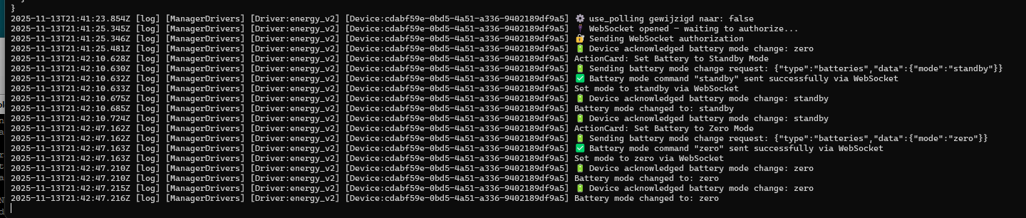

Not sure which P1 you are using now as url is empty so Homey has no clue where to connect.
But I might have found a different way. Websocket command as a replacement for fetch.

I used the same flow with the P1 where the batteries are connected to. The card is run instantly where normal it takes some time.
The old P1 isn’t changed to full charge anymore.
Pushing v3.8.15 now, this will adjust those cards to also set websocket messages
a365e340-dcf8-4c66-9298-3355c2072ba6

Strange, what you try is turn of websocket and use polling mode instead.
Its in the P1 advanced settings and there is a toggle to enable polling mode.
This will stop websocket method and fallback to fetch mode with polling per x seconds.
But it is strange that the log shows:
2025-11-13T15:16:17.562Z [log] [ManagerDrivers] [Driver:energy_v2] [Device:c76ed9d6-99fd-46e9-b534-1a3963ebb4dc] Battery mode changed to: to_full
2025-11-13T15:16:17.563Z [log] [ManagerDrivers] [Driver:energy_v2] [Device:c76ed9d6-99fd-46e9-b534-1a3963ebb4dc] Battery mode changed to: to_full
Which hints me that battery did change and it want to update the settings

Recreate/rename the P1’s so the flow card point correctly. The card is linked internally so hard for me to track/understand what you are telling/sharing with me.
renamed both
80568781-8c02-4efa-bdc0-5fad4a0ff4c1
Name P1 in the card changed automatic
old P1 changed to full charge, good P1 no change
Delete old P1?
Its a bit confusing as one is fetch based and the other is websocket and your .131 is struggling.

Hi, I’ve tested here and it works with me both API and Websocket.
So getting the feeling its something with your setup.
As far as I know only 1 P1 dongle can change the behavior of the batteries, while I think I was reading you expect to control with both P1’s which is not the case.
live
v3.8.16
  • Updated APIv2 to add more text upon fetch failed
  • Websocket based battery mode settings added (both condition and action)
  • Websocket heartbeat (30s) to keep battery mode updated (workaround as battery mode is the only realtime update when it changes)
  • P1 & EnergySocket driver (apiv1) http agent tuning (ETIMEOUT and ECONNRESET)
Hi Jeroen.
I expected only one P1 to change the Battery Mode. New app version .16 was installed.
So I removed old P1 (.22) and got the message β€œcould not be removed” but after restart app that P1 was not there anymore. Using the flow for the correct P1 (.131) had no result. So I removed that P1 also from Homey. Reinstalled it and registered the IP number and use of web socket.
It works, al flows (full charge, Standby, Zero) are working.
I haven’t added the old P1, will not do that, I will not use it anymore.
Thank you for your help, I’m glad things have been clarified!!
