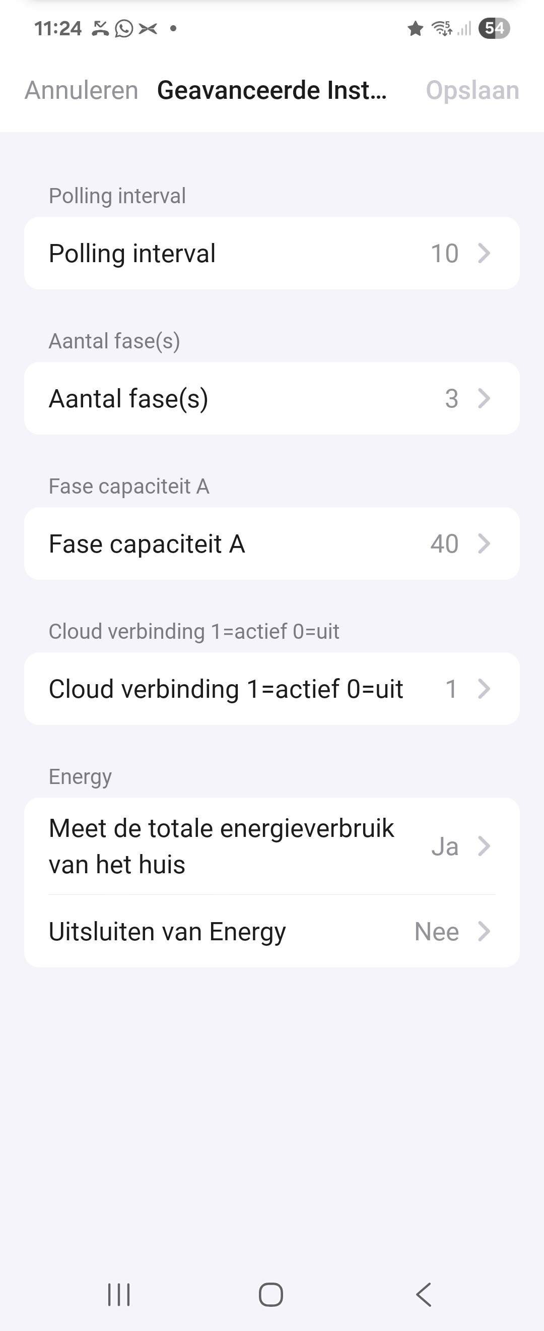

Ok so polling is not a cause. As there users had set this to 1s and the whole homey crumbled.
Is your P1 extra powered by an usb adapter? Sometimes it can improve the wifi stability.
Further checking / moving Homey and or access points a bit to improve reach is something to try.

I have the same issue. Has worked without issue for the past 6 months an recently( last weeks) been loosing connection same as you screenshots and only app restart would fix it. So @Jeroen_Tebbens if you need more diagnostic reports for debugging or find simularities in the setup let me know :grin:, happy to help. And setup is 10s and always has been.

Wifi is 100% and within 1 meter, so that can not be the problem and was it also not in the past.
After running test version, till now it is stable.
The P1 is indeed powered by USB from a Powerstrip, so no additional power adapter. But in the months behind us, this was not a problem at all. It is started after you introduced the battery to the app.
