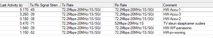

Every time after a update one or more devices are not responding. I know that a reset of the wifi network will fix this, but this not a solution. It is possible to store the connected IP address in the app devices for reconnecting. So there is less mDNS involvement to reconnect.
As you can see in the screenshot all HW devices are seen in mDNS.

At my wifi u see 5 homewizzard devices the only one wat not working (till i reinstall it) is the “HW-pv-woning” that is the 3fase meter.
Routing is for all devices the same.
The second 3fase meter is at the garage (other AP) that one works fine is als a newer model 3fase meter.

Does it appear in the mDNS browser/discovery app (see first post in this topic)
Not at home, and remote i can’t use mDNS
Ok at home.
Started mDNS and i see the 3fase meter who not working at my Homey.
But the 3fase at the other room i cant find but it is working
With the homewizzard app i reconnect it to my wifi, and not its is working again.
Everything works now again, strange.
