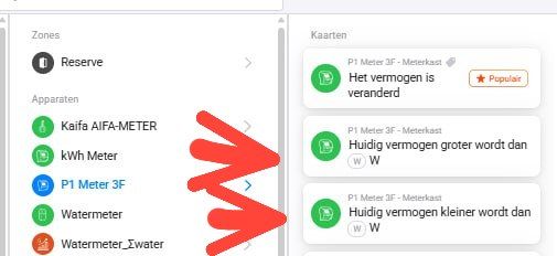

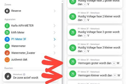

Four IF actions higher and lower power for one 3 phase meter.
I don’t know what’s the difference between power and current power.
Check your device values it might be a duplicate with same value.
Indeed, looks like a duplicate.
Slow polling = same value
1 sec. polling = not always the same.
Foto = fast polling
