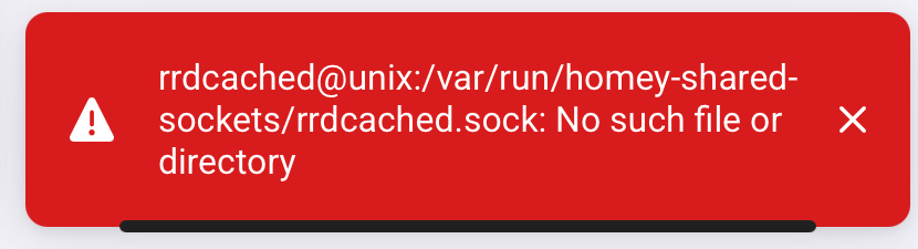

I have two items that have the same values from the past. “Huidig vermogen” and “Stroomverbruik”.
“Huidig vermogen” stopped since the upgrade to the new Homey 2023, and “Stroomverbruik” is still active.
Tried to delete the date from “Huidig vermogen” and get this error:
No problem, Arnold.
Oh, bummer.
Because I noticed the word “cache”:
Try to force reload the web page, or open it in a private tab, and then delete the entry. Maybe that works.
If not:
You’d contact Support about why deleting an Insights entry results in that error after migrating.
