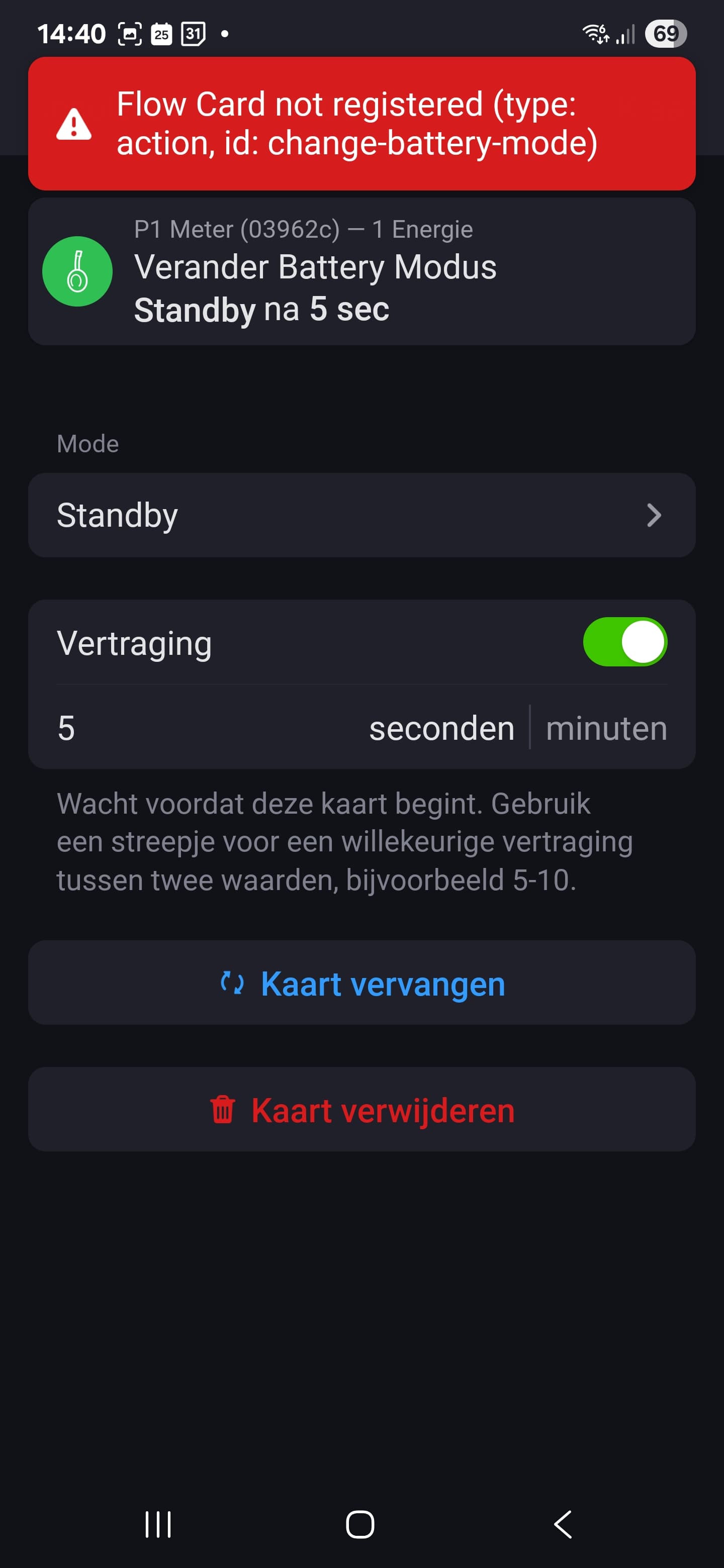

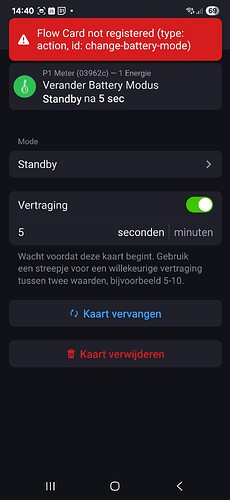

Hi Jeroen. Tested 3.6.30 (didn’t get new version yet).
I get the message Flow card not registered (type: action, id: change-battery-mode) when changing the mode by a flow.
When I change the mode via the P1 settings it change the mode in a right way.
Perhaps it is an idea to mention the status of the mode in the settings screen?
Yeah finally managed to get card registered in latest test. So try that one.
