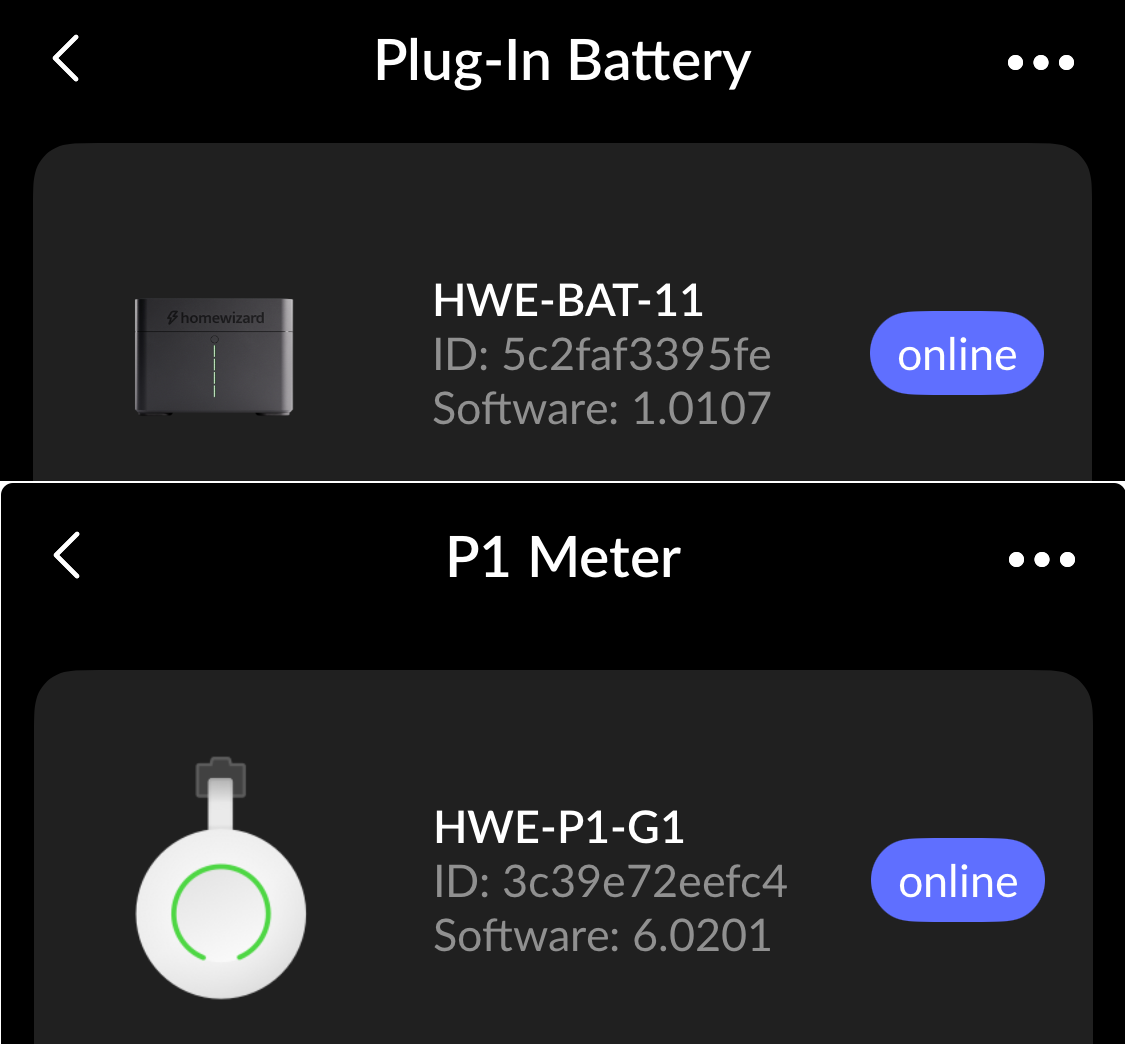

Which firmware is your P1?
url: 'https://192.168.x.x/api/batteries',
status: 404,
statusText: 'Not Found',
headers: Headers { [Symbol(map)]: [Object: null prototype] },
counter: 0
Right that makes sense. Firmware 6.0200+ has the batteries api. Still beta so have to wait someone else can try.
So basically you’re saying it should work? Unfortunately not with the latest HW beta firmware for P1 and PiB.
Diagnostic Report
6c749be3-8739-4baf-9f27-d59c41a227a5
Ok, does it work via advanced setting?
YES! Didn’t try that earlier.
Yes! Finally :heart:

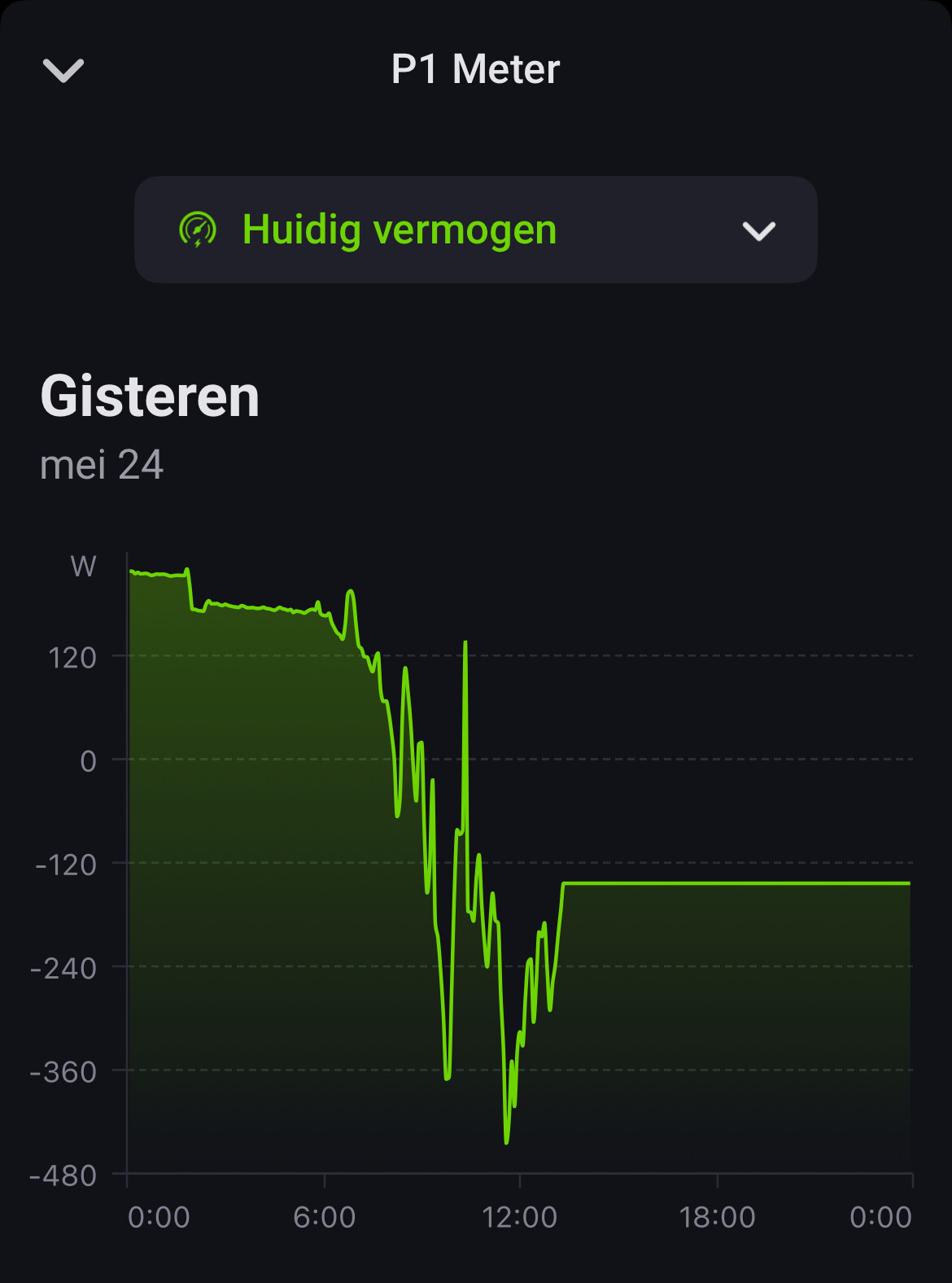

I upgraded my Homey from the 2019 to the new 2023 version. Did a restore of the backup as described in the Homey articles.
Since then the graph “Huidig vermogen” isn’t working anymore.
Is there a solution to fix this?
Please sent a diagnostic report from my app so I can check your logs.
Her is the ID ec2fea07-7c23-4a01-9d29-3720e4cd44ef
Thank you!
Hm, no errors. Think its a very old created metric.
Please check here and search your device (p1 name you have problems with (capability measure.power without value or null).
The capability has a value that changes frequently
