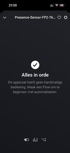

Hey Martin. I had issues with my fp2. I set it up again but i don’t see the sensors/identities. Already changes the names of the labels but normale you see al the zones(sensors) in the screenshot I send. But it only says everything works. In the log i do see an error. LTPK not set is the error. Any advice ?I did a full reset as wel but keep getting this ltpk not set error
@Martin_Verbeek kan je mij helpen?
