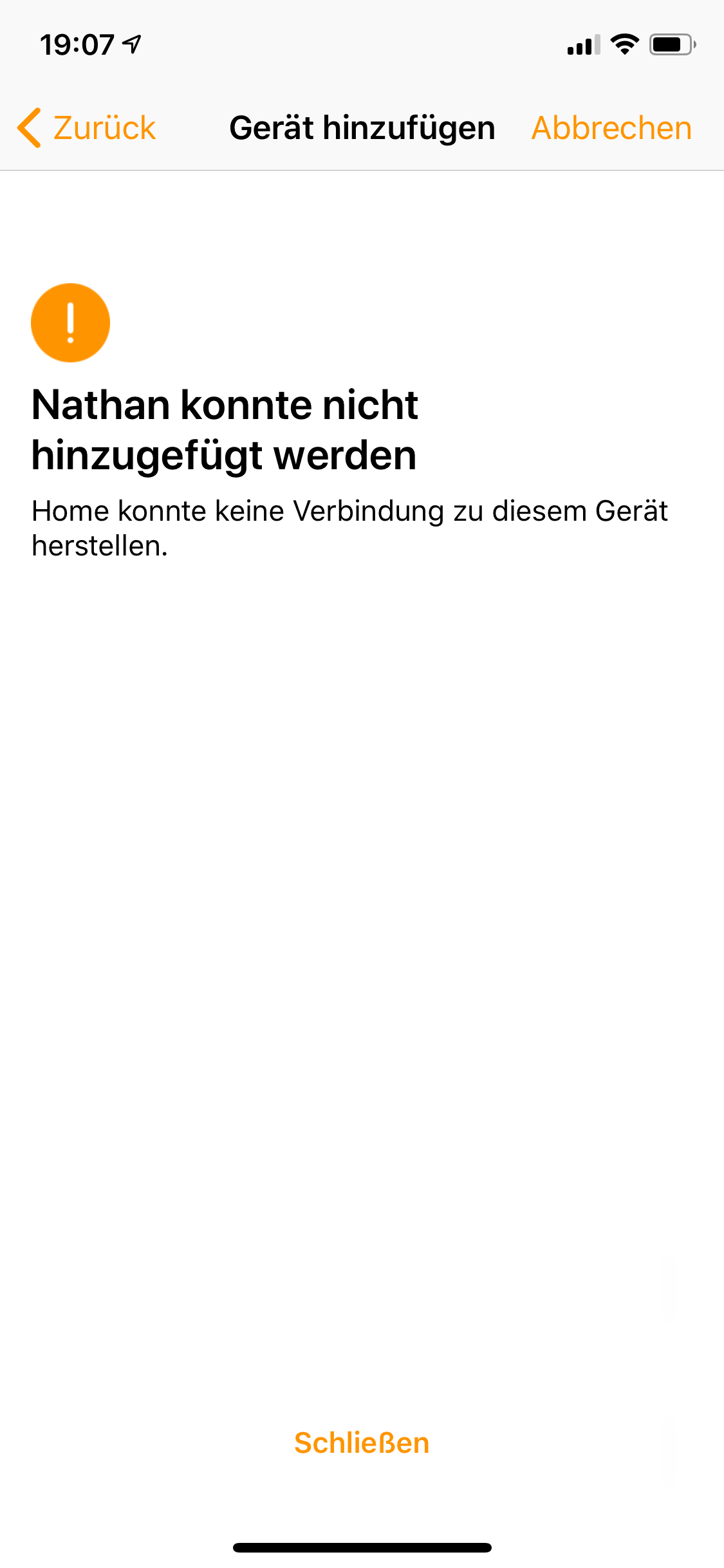

strange behaviour of Homey(Kit): Suddenly all devices where gone in HomeKit, Homey was shown in HomeKit correctly without an error. Tried to restart HomeyKit, no success. Tried to restart Homey, no success. tired to delete HomeKit data in the app, no success, tried to give Homey a new name in the App, no success, delete the bridge, the app and reinstall, no success.
Homey could be found, but not connected. Any idea why?

Looking back at your initial post, what exactly do you mean with “Homey could be found, but not connected”? Can you post a screenshot on what it looks like?
Well, like I wrote homey could be found when I try to add a device:
Next Step, I can enter the configuration code and then, this:
Given that you can change the name, I assume that you have installed the beta version of the app. Can you try uninstalling it and moving back to the stable version?
