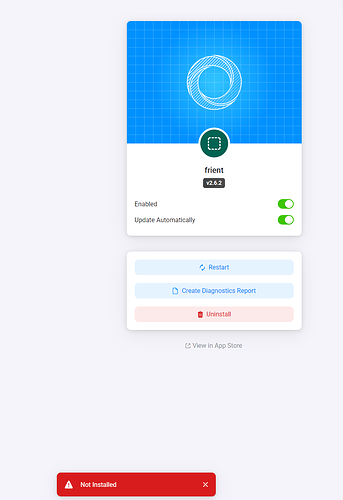

Frient app states: "not installed"
Suddenly my Frient devices do not work anymore. They claim that the (Frient) app is not available. But it is still installed. When I restart the app I get the message (see picture below) that it is not installed. I uninstalled the app, installed it again from the Homey website, restarted my Homey. Result is the same. The app is there, but it keeps telling me that it is not.
What has happened, what to do, … ?
(Latest app I installed before this happened is the official Somfy app).
Possibly related to the Cloudflare outage. Just wait until that is over and try again.

So, I just restarted Homey in an attempt to get something else working (Messing around with a camera) but when Homey got back online, my smoke detectors that have been working for like a year suddenly became unavailable (Frient smoke detectors), I then went to the Frient app and hit “Restart App” but then got a message that the app is “Not installed”, I tried rebooting Homey once more and now even the icons are gone. What is this? There is no “Repair” option on the devices either since it doesn’t realize it is connected to the Frient app anymore. I tried installing the Frient app again but nothing happens.
